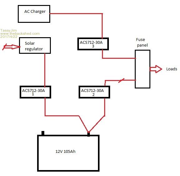

The ACS712 is a 5V device and with zero amps, it's output is at half VCC or 2.5V
I decided on 30A modules and wired the primary circuits so that increasing amps gives a reducing voltage output. This means that I can handle +30 amps and -11 amps without going off scale.
There should never be -ve amps on the solar side but when the AC charger is running, it will be back feeding into the battery at a maximum of 12 amps minus the load of at least 1.1 amps. That's close but not too close. The charge would only put out 12 amps while the battery is very flat and that shouldn't happen.
I wired the charger directly to the fuse panel so that the battery can be fully disconnected while having the load maintained.
I started with the two ASC712 modules for solar and load.
The readings were good for a few days then the zero amps started to wander. The output of the modules is temperature sensitive so I added a DS18B20 and did the calibration maths.
It worked, sort of, but still not happy.
The other cause of reading errors could have been fluctuation in the 5v supply to the modules or the 3.3V supply to the micromite.
A pair of 10k resistors across the 5V supply and used as a reference would eliminate both sources of error but I decided to use a third ASC712 as the zero current reference.
That worked beautifully and over a few weeks and a range of temperatures, the solar zero current was consistent as well as the base load current of the load.
Happy days! But since I had the ACS712 doing nothing, I wired it into the AC charger output.
Now the third module is used as the zero reference whenever the charger is off and the last zero is used for the time that the charger is running. The maximum run time for the charger has been set to 2 hours so for that period of time, the current readings will be off slightly but after a few weeks of monitoring, I am happy.

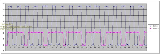

The solar regulator (a cheap ebay one) uses a slow PWM with a frequency of 10 to 25 Hz. This slow switching keeps the strain of the switching transistors but makes taking a reading awkward.
I ended up taking 100 readings over 600mS and averaging them. As well as giving a stable reading, it allowed me to record the maximum reading of the 100 samples and use that as the available solar output for the reading.
Readings are taken every 10 seconds and placed into their time-slot of the array. It is done in a way that will always have the average for that time-slot, no matter how many readings have been entered.

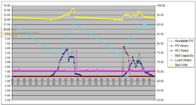

So far, I have been charting the output in Excel
On the first day, the dip in the solar output is caused by the shadow from a tower. You can see the green trace of the maximum solar in the second hump of day one. The regulator was starting to limit the current as the voltage rose to 14.3V
At about 4pm the solar panel is shaded by trees. About then the transmitter was used and the load increased for a while. It normally sits on 1.1A when on standby.
At 7am on day 2, the battery voltage dipped below 12V so the AC charger (Brown trace) came on for 2 hours. Just as well because it was cloudy that day so not much solar contribution. Still enough to do a bit of regulating.
The cyan trace is the estimated remaining capacity, not something to take too seriously.
This graph shows the PWM of the solar regulator for two different conditions and the 100 readings used to record it. the full time shown is about 600mS
