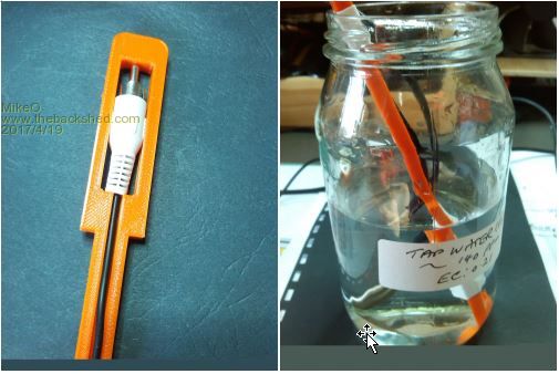

The following conductivity meter is based on an original project for Arduino here
The original used an American 2 pin power plug as a conductivity sensor, my version is a little different using the ubiquitous "RCA" phono plug, seen here complete with 3D printed holder. Link to STL file
You also need a waterproof Temperature sensor (18b20). The Cell is powered through a resistor (470 ohms) from two outputs on the mite via pins ECpower and ECground. Power is applied to the resistor + cell network briefly whilst the junction voltage is measured then turned off, the voltage is then reversed for a brief period to help with water polarisation. The code is fairly well commented and should be self explanatory. Operation is simple and should work straight off but calibration is recommended. I didn't have any commercial standards but was able to make some simple NaCl solutions which seemed to work reasonably well with the aid of this calculator. I made two TDS standards, a 1.5 (1000ppm) and a 3.0 (2000ppm) with 0.29 and 0.58 grams in 250ml of filtered water respectively.
Run the software and follow the prompts, if you are going to calibrate the new cell constant may be saved by pressing the S key, you may need to wait out the 10 seconds cycle time before its is saved. The following is a typical Calibrate and Measurement run.
New Callibration has been saved
Restart in Measure

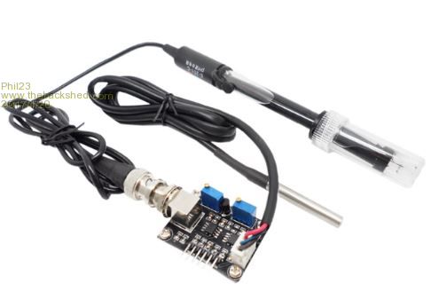

Continuous pH monitoring is what I'd find really useful, but not sure if the readily available probes are suitable for 24/7 immersion for continuous monitoring.
I gather periodical re-calibration might be required, and have seen quite a few continuous pH monitors in service, but they usually have $$$$ price tags.
Anyone here know a good starting point for this type of pH monitoring.

You and I and a lot of other people would find that very useful Phil - in my case to control the pool pH. Unfortunately I don't think anyone has yet come up with a simple system that will do this at all reliably.
To be able to use pH for control (i.e. not just with colour indicators), pH pretty much universally is measured with a glass electrode which is very delicate and easily and quickly fouled when used for continuous monitoring. Even in pools, which normally have pretty clean water, they foul up fast and at a guess I'd say careful daily calibration with buffer solutions would be necessary. Over longer periods (and not that much longer) they would need cleaning and probably replacement of the electrode solution every week or so. The whole electrode itself won't last long (a few weeks ??) and still be able to give accurate results in a continuous monitoring mode.
In the laboratories I've worked in there have been good chemists who understand pH electrodes well, but most would admit having been frustrated by pH electrodes at some stage or other.

One of his monitors, runs 24/7, & yep it requires periodical recalibration, but certainly not daily. Gets checked against a higher grade hand held unit most days, but it's pretty low maintenance.
More recently he's put in a residential pool & it also has 24/7 ph monitoring & also on demand acid feed to keep pH correct.
I know the probes at the fish farm are readily accessible for cleaning etc, but the pool ones are inline & not so readily removed.

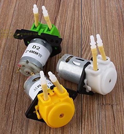

The couple of devices I've seen so far are these, & I could put both of them to use...
It seems to be getting more common for domestic pools to have automatic acid dosing, so there my be a fair degree of reliability available now, given how lax owners can be with correct maintenance.
If you could reliably read pH, it would be easy to calculate acid dose required for a pool to maintain the balance.
I'd assume it would be introduced slowly, main pump running, and the control would be required not to exceed specified 24 hour doses.

A pH electrode is a voltage source with high impedance output. Generally, a very low bias current op amp is used to measure its voltage, femtoamp is not unheard of. That can be followed by an offset and gain adjustment to convert the small voltage to a pH value.
I have seen circuits probably in a low bias current op amp data sheet.
pH 0 = +414.12m0V (Acidic). pH 4 = +177.480mV (Acidic). pH 7 = 0.000mV (Neutral).

  Quote  The couple of devices I've seen so far are these, & I could put both of them to use...
Yes I've looked at those too but don't trust the 'reliability' prospect. The meter (i.e. board) should be pretty reliable - it's amazing how far the chip amplifiers have come, and the temp. probe won't be a problem (you have to have temperature to adjust the pH), the electrode is the issue. Those ones are plastic on the outside and that makes them more robust but the membrane inside will still be very thin glass.
Those pumps are peristaltic pumps - rotating rollers squeezing a tube. They're commonly used for dosing small quantities intermittently; they're cheap-ish and pretty reliable.
  Quote  I'd assume it would be introduced slowly, main pump running, and the control would be required not to exceed specified 24 hour doses.
Yes, definitely with the filter pump running. I think just using a timing basis for dosing would be the way to go. Run it for a few secs, then off for a minute or so to disperse it, then run again etc. several times for a total of 'n' secs to deliver say 100 mls at a time. The acid should be pre-diluted too I'd say (maybe 10:1?). It takes an hour or two for most pools to circulate the water enough to stabilise pH after dosing any chemicals, so you probably wouldn't want to be dosing acid more than a couple of times a day because it will have to be done during the 'main pump on' filtration periods (2x2 hrs/day in winter and 4x2 in summer for me).
