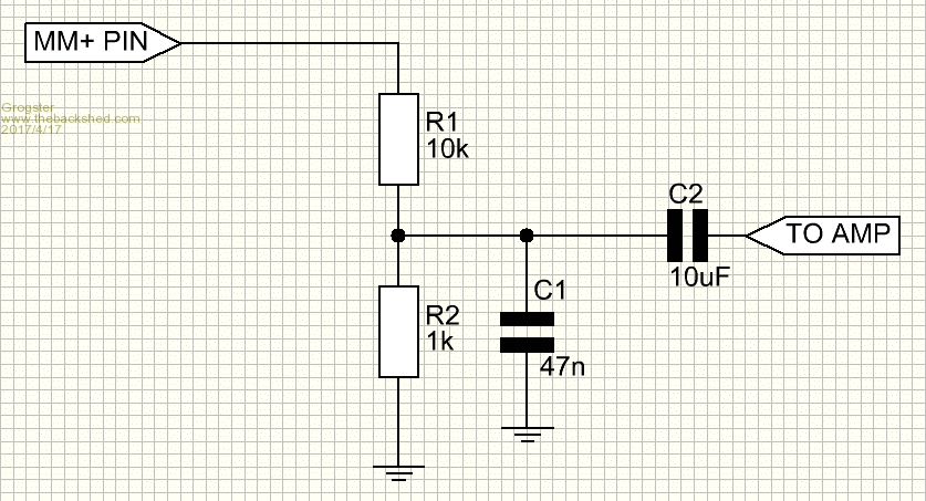

Here is my current output filtering, which is still popping:
R1 & R2 form a potential-divider to drop the I/O pin voltage down to around 300mV to suit the amp I am using, C1 filters off most of the carrier, and the 10uF AC-couples to the amp.
I have also tried the more standard Maximite filter, and the PICAXE filter too. Nothing stops the pops.
Playback is just fine when it is taking place.
It is just the start and stop pops which are substantial once amplified.
Is there any way we can perhaps go back to the original concept where you need the extra PLAY CLOSE command? Perhaps you could post a version of that HEX here, and I could try this out, and if it solved my problems..... It seems to be that when the PWM starts and stops, this is what is causing the pops, so if we can keep it running, then one would hope that would stop the pops - but prevents you using those pins for anything else I guess.(until you PLAY CLOSE, that is)
What happens if you add a 10k pullup resistor to the processor pin in this circuit?

  Grogster said   Yep, tried all sorts of things from caps to pull-up resistors and a cap, but you can't get rid of the loud pop at the start and end of playback.
So, yes, have tried that too hoping that perhaps biasing the pin would help, but it does not.

flip
Joined: 18/07/2016
Posts: 127
Posted: 02:01pm 20 Apr 2017
+1 hitsware...Also maybe the series cap (10uF) would be better straight off the MM output pin...(+ve end to micro) (-ve end feeding the divider)...Also you could bias the output of micro to static mid-point of 1.65V by using say 2 x 100k resistors in series from 3.3 to 0 V...with the junction of the two resistors connected to micro output... this allows you to turn the pin off in MM code, so it would be off at all times when not sending PWM output...this, in combination with the circuit, will allow the MM output to settle and remain at a DC midpoint of 1.65V. (assuming PWM code always modulates [with no DC offset] around a perfect 50:50 duty cycle)
