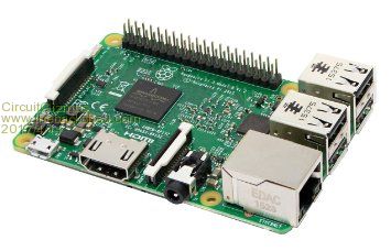

I would think that the lowest effort (and cost) would be made using a Raspberry Pi.

Posted: 05:47am 14 Apr 2017
  JohnS said   That was what I thought till it turned out it has to be wired.
Could be a Pi + external LAN board (ENC28J60 etc) but it's about the price of the board I posted and messier.
I must be confused. A Pi has a wired Ethernet port. Hardware could be Pi, LCD, button(s), battery.
Software possibly Python.

Posted: 06:02am 14 Apr 2017
Only some have a wired port. They cost more than what I posted don't they?

Posted: 06:35am 14 Apr 2017
I was thinking the cost of the total solution. I didn't realize that the Orange had the same pinout as the Pi and could take the same LCD/button boards.
