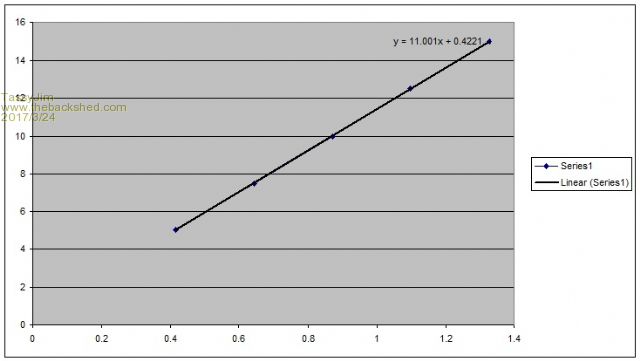

I cheat and put the readings into an excel spreadsheet then add a trendline to the graph
A very linear set of data points.
The formula is V = x * 11.001 + 0.4221
In your setup, the voltage drop across the diode is 0.4221V

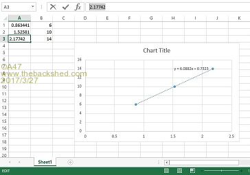

Loading the figures into EXCEL:
The equation is not far out but when I take further measurements using these figures at 6.00v input I get 6.48445 and 12.00v I get 12.4812. I still cant see why there is a variation during normal program execution and the calibration area of the code.

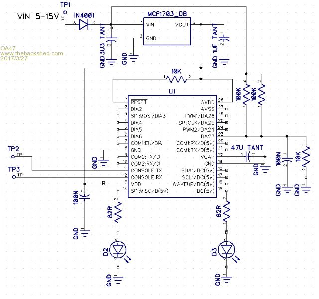

Posted: 06:49pm 26 Mar 2017
0.73 seems high for a schottky diode.
Perhaps there is not enough current through the diode to give a consistent voltage drop.
With the second set of reading both showing high by a similar amount, it does look like a shift in the diode drop. It also could be temperature related.

@ Jim, the particular circuit I got those figures from had a SMD equivalent of a 1N4001 diode that I measured @0.59v drop using the diode test setting on the multi-meter.
@ Chronic, for the reasons of test, I gained these figures using the minimum of components. I scratched together a circuit, hope it helps.

For 6V input should read exactly 1/6 of 6V = 1V. 10/(10+50) = 1/6.
If you're using it to work out voltage at TP1, maybe better putting top of divider to TP1, otherwise, with circuit as-is you could get variation of maybe .3V depending on the variation in current load during sleep.

[I wish I could produce schematics that fast !!]
I think the A/D supply (which is also the ref voltage) is getting hash from the regulator, try a 0.1 uF bypass (ed -ceramic). There is a Silicon Chip project, I forget whether it was a voltage reference or power monitor, that had a similar set up and problem, fixed OK. There are a number of other things but that would be the most citical I think. Also diode voltage drop alters with current to some extent, even for schottkys.Edited by chronic 2017-03-28

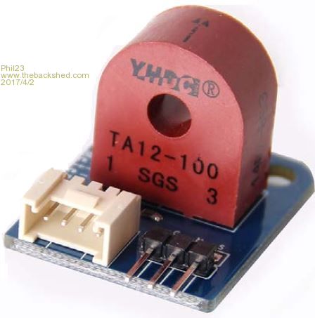

  TassyJim said   For 3A AC, I would use a current transformer and rectifier then use an analogue input pin.
I like to see the isolation.
Same...
So I had also bought a couple of these...
Haven't yet decided which devices to actually use.
1000:1 ratio & 200ohm shunt.
Says 5v out @ 5A which will be AC, but not sure how to deal with the 0.7? of 1.4? lost in rectification.
That would mean losing readings under 0.7 amps with out some other solution.

Posted: 03:48pm 01 Apr 2017
Do a google search for "precision rectifier"
There are simple one op-amp circuits and a few IC's that are designed for the task.
AS well as rectifying, you need to decide the time constant for the output filter - that determines haw quickly the circuit responds to changes in current.

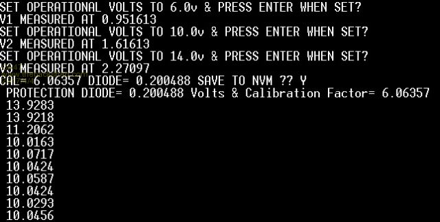

Thankyou for all the replies shedders. Sorry I have not been able to get back sooner but I have been away and I can read posts on my phone but it is difficult to prepare posts which can be easily done on the PC. Getting back to my original conundrum I may have been a bit unclear with my current concerns (no pun intended). I have earlier posted a cut down circuit and I have cut down the code by making it call for manual voltage measurements to try and work out what is going on.
Here is the code for the calibration sub:

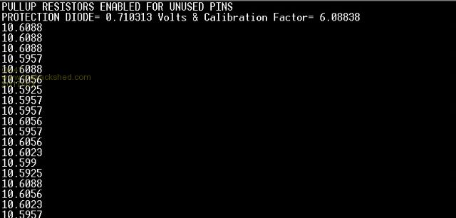

As per my earlier post I received the following samples :
6.00V 0.863441
10.00V 1.52581
14.00V 2.17742
The Micromite calculated the gradient of 6.08838 and offset of 0.710313 using the 6v and 14v values to get the gradient & 10V value to calculate the offset.
The issue is that the future voltage readouts made every two seconds after for a 10.00 Volt input are consistently approx. 0.6 Volts out. I am at a loss to figure out why.
