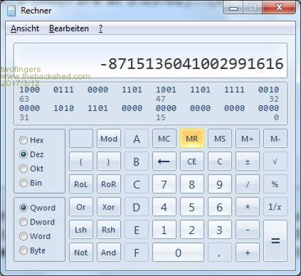

BTW. Windows 7 behaves in the same way :
4865804016353280000 x 2 gives:
Michael
