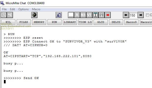

After that I try to open the TCP session to my server and there comes the issue... I also run a whireshark on my server and there is no incoming packets ever. In the debug of MMBASIC, I can see there is a "busy" message after the AT+CIPSTART line...

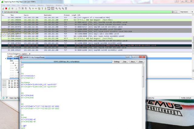

I tried to figure out it is an ESP or PIC issue. If I connect the ESP directly to my pc via serial usb uart converter modul, I can use 'putty' or 'termite' program and I can communicate with AT commands perfetly and I also see the incoming session in my whireshark log.
But, unf. when I connect the ESP back to the PIC, it start, can connect to wifi, it is pingable, but cannot open the TCP session, because of "busy"...
1. pict: direct connection ESP_to_PC, manual send AT commands via termite
2. pict: ESP is connected via the PIC32, commands send by MMBASIC code, no any incoming tcp session from the ESP to the server.

BECAUSE,
At the end of each Print command MMBasic sends it own CR LF
so
PRINT #5, "AT" + chr$(13) + chr$(10)
sends AT CR LF CR LF
and that triggers the Module to reply with busy p...
so
use a semi colon (and MMBasic will suppress its own CR LF)
PRINT #5, "AT" + chr$(13) + chr$(10);
or of course just
PRINT #5, "AT"
to send AT CR LF and get a happy response from the module.
