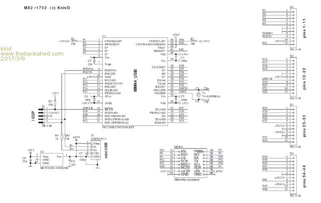

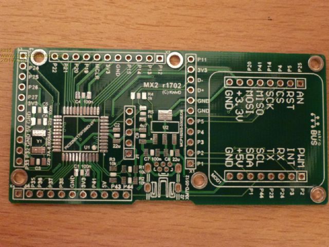

Presenting a small and simple development board for the MX270 Micromite. I designed it originally for my development needs, but made some extra number of bare boards as well. Turns out the MX270 chip did a pretty good job for me in one my more specific projects.

Excellent pcb, compliments !!
In this post MX270-USB you have specified:
23: DIGITAL | ANALOG | COM4-RX (shared with the console)
24: DIGITAL | ANALOG | COM4-TX (shared with the console)
But in this PCB I see MikroBUS RX and TX are inverted.
Is this correct way ?

Nice layout Kon..!!
I love how you don't need a USB converter, and can update the firmware thru the bootloader..! Sweet...
Could you post the BOM for this..?
Put me down for 2... If not many available, 1 would be ok also...

The schematic as PDF and the BOM:
2017-03-10_065606_MX2.zip
To avoid confusion: knivd@me.com - this is my paypal address.
The crossed lines for COM4 are correct - TX goes to RX and RX goes to TX.

Yes, that was a bug... :(
I didn't have any need to use MikroBus with MX2 so that had slipped away. This is the fixed schematic. The only difference is the swapped P23 and P24 to the Click board. For Click boards using analog, I2C or SPI, the old r1702 revision is still completely fine.
I will get a few revised boards r1703 made just in case.
