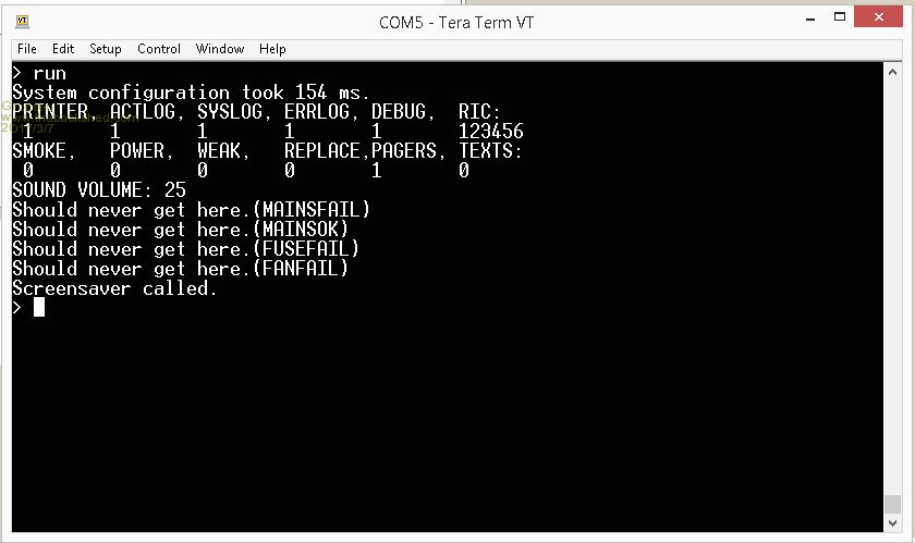

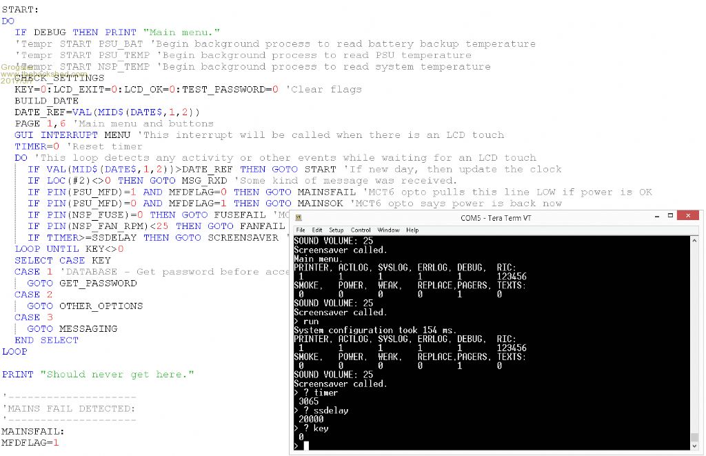

This is really odd:
The SCREENSAVER routine should NOT be called, but it is called as soon as it runs into this command in this loop.
Console output proves that system timer is less then SSDELAY, but it just loops over to SCREENSAVER anyway - what gives?Edited by Grogster 2017-03-08

There is simply not enough nested depth within MMBASIC to do all I have to do inside the select case, so it won't work when you have about ten different GUI menus under each one of those GOTO's, as you would end up with about 50 or more deep nested loops - about the only way I could deal with it was with GOTO....
Here is the complete code for that section, and I am now getting results from all the labels that should not be executed unless the timer was greater then or equal to 20000
Yes, OPTION EXPLICIT used at the top of the code - has saved my bacon many times when I get variable names wrong etc.
[Quote=matherp]If not probably a typo somewhere e.g. the setting of SSDELAY which you don't show[/Quote]
Yes I do. It is in the console output part of the image above "? ssdelay", which returns 20000.

So what's odd about this one, is that the code should never get out of that first loop, but it is, and I don't see how.Edited by Grogster 2017-03-08

I think I am on to something here as to what is causing it. Standby......
EDIT: Yep, I know what is causing it now.
Schoolboy mistake, really - should not write code at 2AM.
The routine that was tripping it up was actually MAINSFAIL.
This is 100% correct too - the code looks at the opto-coupler, and as there is no connection to that just yet, the on-board 4k7 was pulling the pin high, the code sees that, and hops on over to MAINSFAIL.
.....and because I had not written those routines just yet, I just put in the labels to keep the interpreter happy, so it was jumping over each one('Nothing to see here! Move along!'), then it runs smack into the SCREENSAVER code, so executes it.
Bah!
Sleepy time now, will fix this up tomorrow.Edited by Grogster 2017-03-08
