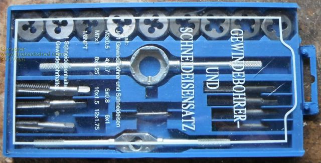

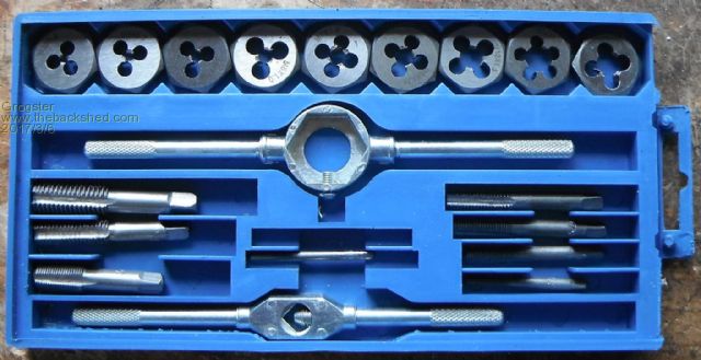

Yeah, I was just using the "Black" metal taps, and they are bloody useless.
They come as one final thread size only - no starter, no 2nd, no 3rd, just the final 3mm size and that's it. They are cheap rubbish, and I fully acknowledge that these are probably best thrown into the skip right now.....
I will see if I can find any of those brands on the web - hopefully one of them has a webstore. Not sure where I could find something precision like this here in NZ, cos our hardware stores only have the cheap crap.
So, in other words, I was trying to tap the 3mm thread directly, in ONE operation, with ONE tap, which was the full 3mm size. Obviously, this is NOT how it should be done, so I need something of better quality and precision, so I can do holes like this correctly from now on.

This is the crappy set I have:
