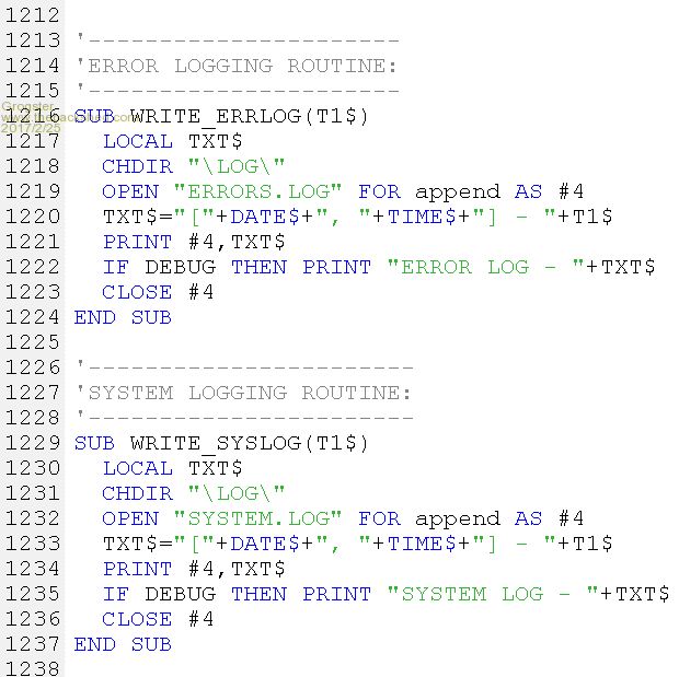

I have two subs that I call as and when needed, to log system errors and other system activity. They usually work fine, but tonight they have started doing odd things.
The two routines are:

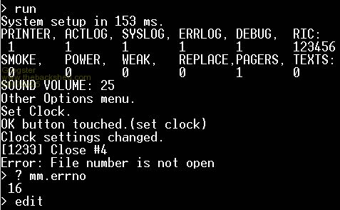

...and the error I am getting from this code is:

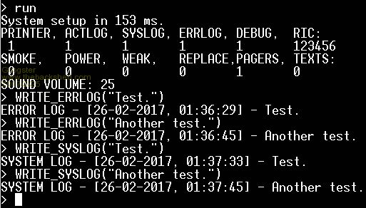

...yet, if I run these directly from the command prompt, there is no problem:
It's damn peculiar. I have searched for all instances of "#4" in the code using MMEDIT's search feature, and have confirmed that each and every time that handle #4 is opened, it is always closed again. It is never left open.
Note also that as part of the SUB being called, I close that handle before leaving the routine. The next time I call that routine, I get this error message about the handle already being open.
BUT, I can call either sub from the command line as many times as I like - no error message, but when the code is running, I do. This suggests that I have accidentally left handle #4 open somewhere else, but according to my MMEDIT search for "#4", anywhere I open it, it also gets closed.

EDIT: One last thing before bed, I tried simply putting in a "Close #4" just before the open command, but then I get a different error: "File number is not open.", along with mm.errno being 16. If I remove that CLOSE #4 and run the code again, I get the other error about the file already being open - WTF?! It can't be both....

In case you might call one as a result of an error, that might cause it.
(Suppose DEBUG was garbage, or ON ERROR something or ...)
You could reduce the window for such by moving the CLOSE up a line and by setting TXT$ before the OPEN.

I think the
PRINT #4,TXT$
statement is processor friendly and knows it could take awhile so completes in the background. This means any interrupts (e.g settick,touch down etc) can be serviced while its writing to file. If one on these also writes an error then the SUB is called again before its finished, so the file OPEN/CLOSE confusion happens.
