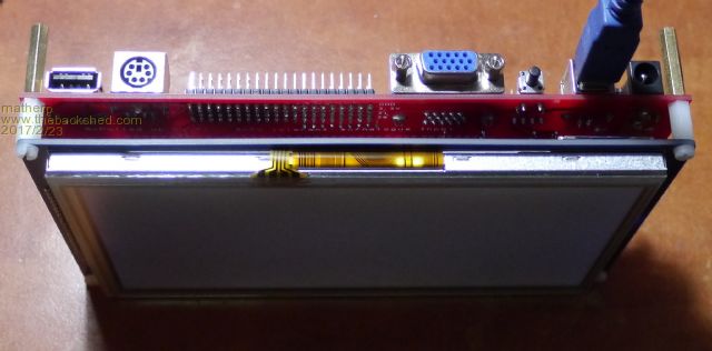

I use 12mm M3 spacers to mount the TFT e.g. these Edited by matherp 2017-02-24

Posted: 07:53am 23 Feb 2017
Here is a screen mounted on 12mm spacers and using 22mm spacers as stands to sit flat on the desk

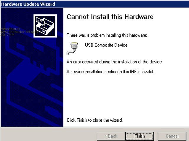

I'm still stuck with the composite USB device issue.
Tried all the available driver versions.
I suspect my PC USB port power output is not man enough to drive the board properly.
So the driver fails to install.

I pulled the PIC 16F chip from the board as i could not get it to talk with any of the USB XP drivers suggested. Always had that exclamation mark in device manager.

Put the 1455 back and use this driver on the documentation tab. This is known to work with XP.
Otherwise I suggest you return to WW to sort out for youEdited by matherp 2017-04-04

Do make sure you try the Driver in PeterM's link. I can also email it to you but some email servers 'strip' the attachment.

I re-downloaded the driver and put the chip back, the driver still fails to load correctly. With the below message ..
