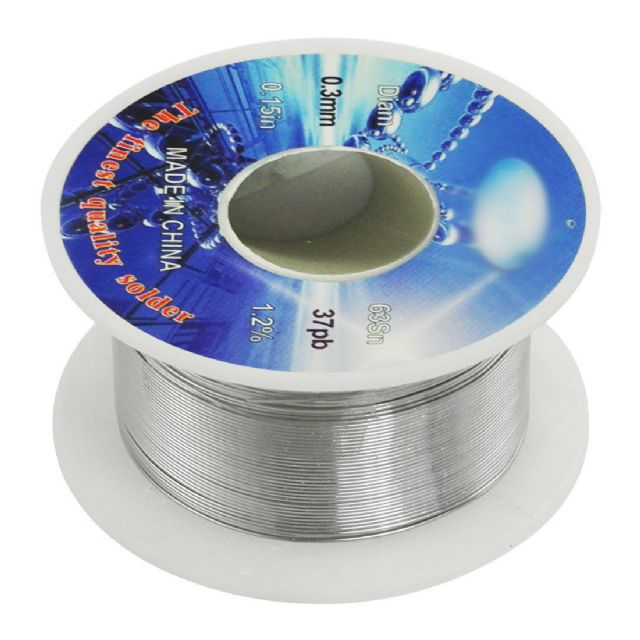

  Grogster said   Do you have any really fine solder? 0.5mm or 0.3mm?
Beware!!
I have been using some 0.5mm solder for my SMD stuff for a while and recently bought 2 rolls of 0.3mm `stuff' off a well known Auction site and they arrived a few weeks ago..
DO NOT Buy anything that looks like this picture!
The `solder' leaves a horrible black crusty substance and it also seems to have some impurity as it doesnt seem to melt fully and leaves something like a grey metal residue.. It also cools with a very crystalline look, not unlike Lead free solder looks but it purports to be Tin-Lead..
Basically I have 2 rolls of paper weights now.
Just as well they were cheap, I dont know what the chemical composition is but I doubt it is Sn-Pb 60/40 (well 63/37) like it says and the resin is ... well carbonish..

Yes, I agree. I bought something that looked very similar to that from eBay a while ago - biffed it as soon as I tried it out. It was complete rubbish.
I get my solder rolls from Element-14, and it is authentic "Multi-core" and "Loctite" brand(made by Henkel) - about $30 a 250g roll for the 0.5mm and about $45 a roll for the 0.3mm - expensive stuff, but you only use a tiny amount, so those rolls last for hundreds and hundreds of board and probably thousands of chips.
These solder wires have never let me down, so I don't mind buying the occasional expensive roll every five years or so.

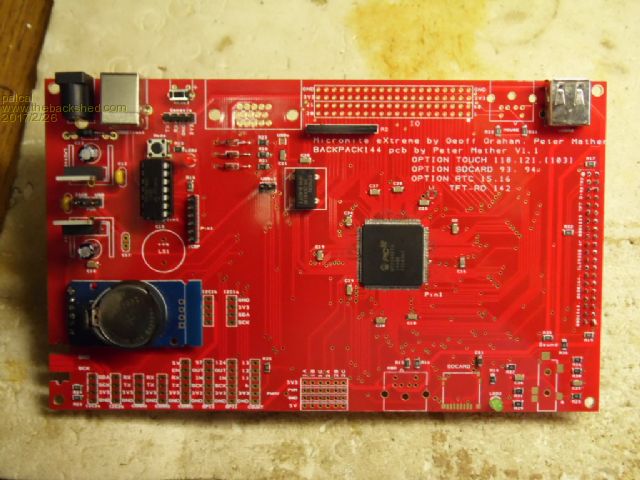

It is up and running and the Heartbeat LED is flashing. Here is a picture, still a few sockets to mount (waiting on delivery), the PIC soldering is probably not 'factory' but looks are not everything.
Paul.
