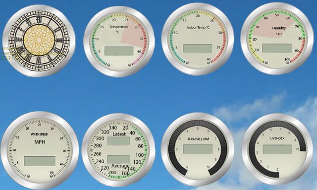

What I want to end up doing is understand how the gauges actually work so I can add or delete gauges if I change the program/dials and also how to get the gauges to display the information I am going to send them
For example some of the gauges I will need to move 360°
some will need so move around 240° or maybe a bit more
You can get an idea of what I need from the picture below
IF anyone has the patience to try and explain it please.........

Posted: 11:16pm 21 Feb 2017
Lets forget CFunctions, we don't need them anymore, and make sure you have 5.3.02 loaded on a MM+. BLIT is then available on both the SSD1963 and ILI9341 displays if wired correctly (see the manual)
Make sure this is the case by loading an image and then typing
BLIT 0,0,100,100,100,100
The 100 by 100 square at the top left of the picture should now be replicated diagonally below and to the right
If this isn't the case you have a wiring issue.
Now study the attached program but also reference this thread which shows how a pointer is constructed from a series of triangles. Why triangles? Because you can draw a filled triangle in any orientation and of any shape.
A rectangular pointer is comprised of just two triangles like the centre two in the diagram in the previous thread. The example below uses four to make a more complex shape.
I've commented the program so it should be easy to follow what I am doing. At the simplest level adding multiple gauges and pointers is just a matter of replicating the code and data structures. In this case you would use a different BLIT buffer number for each pointer so they can be updated independently.

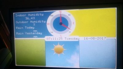

Posted: 09:26pm 15 Aug 2017
@matherp @disco4now or anyone really
I found one "slight" problem
The needle on the gauge works perfectly, however while running the test overnight where I do a simple loop test ie the needle goes through all 360° and then runs again doing the exact thing
I end up with 2 needles
The original stuck on the North position 360° and the "new" needle doing what it's meant to do - moving 1 step at a time till it reaches north again
Anyone got any ideas why this is happening? or even better telling me how to clear the original needle before it starts drawing the new needle
I "think" it's to do with the "blit read" but not sure
I tried moving this into the loop where the needle gets drawn but it doesn't work there. (it says "buffer in use")
I'd like to solve this as it will probably cause a problem with the direction gauge when I finish the weather display properly
example picture
Edited by lew247 2017-08-17
disco4now
Joined: 18/12/2014
Posts: 1162
Posted: 01:56am 16 Aug 2017
Hi Lewis,
The initial
getlimits(x, y, w, h)
blit read #1, x, y, w, h
lines should only be run once I think. You might have to show how your are repeatedly call the code. The method below seems to work OK for me.
do
' Main program
for b = 1 to 360 'so I can see the pointer move one complete revolution
pause 10 'delay of 100mS so I can see the pointer steps
heading = heading+1 'increment the heading 1 degree clockwise
drawpointer(heading) 'draw the pointer
'print b 'so I can see how many times the pointer moves before it crashes
next b
loop
end
Also a modified drawpointer. i is used as an index. You are getting away with not setting it as you only have one triangle so the default value of 0 is working, but really should be set explicitly based on iterating through the number of triangles, I have added the for i=0 to nt-1 loops where required.
I have also added a loop using the getscanline() function in an attempt to reduce flicker on the screen
Sub drawpointer(angle as float, offset as integer)
local integer last_x, last_y, last_w, last_h, i
  for i=0 to nt-1
'rotate the pointer into the drawing array for each triangle
rotatetriangle(i,pcolour,angle,X_point+X_left,Y_point+Y_top,ptr(0),ptr(1),ptr(2),ptr(3),ptr(4),ptr(5))
NEXT i
last_x=x: last_y=y: last_w=w: last_h=h
blit WRITE #1, last_x, last_y, last_w, last_h 'update old rectangle with saved data
blit close #1 'free buffer
blit read #1, x, y, w, h 'save the new rectangle to memory
local integer k
do
k=getscanline()
loop while (k>200 AND k<350)
for i=0 to nt-1
'write new triangle for each triangle
triangle xx0(i), yy0(i)+offset, xx1(i), yy1(i)+offset, xx2(i), yy2(i)+offset, tcol(i),tcol(i)
NEXT i
drawpivot(offset)
End Sub
