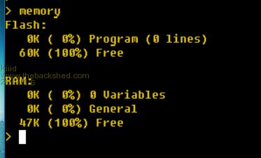

In addition to COM1 and COM2, COM4 is also available now like in MM+, and like it again it is shared with the console UART (although available on different pins), so in order to enable COM4 the console should be disabled with OPTION CONSOLE OFF. The USB console is always available, though.
The speed is also quite good - 1180 grains at 48MHz with active USB console.
In order to make USB functional a crystal is needed, 8MHz in this case. That plus the two pins taken by the USB itself required small reordering of the pinout but it is minimal. Here is the pinout for the 44-pin MX270D chip:

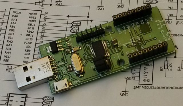

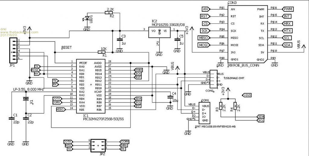

In case anyone is interested in the MX270 version, releasing here the gerbers for probably the simplest development board for it. I have no plans to manufacture and sell any of these but they can be easily assembled by hand at home.
All components are 1206 or similar size for easy manual assembly. PCB size is 77x37.5mm.
2017-02-19_130143_MX2.zip
