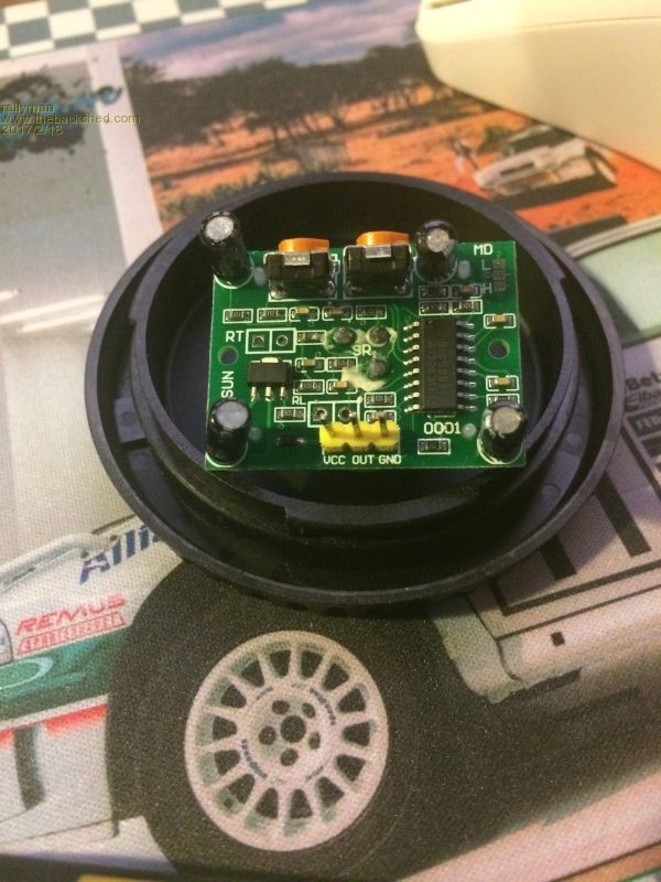

Posted: 01:19am 17 Feb 2017
Hi Rallyman,
are you sure your polarity is right? It seems that you use brown as GND and orange as VCC.
But in this photo is the polarity changed???
Frank

rallyman
Joined: 15/02/2017
Location: Hungary
Posts: 9
Posted: 02:11am 18 Feb 2017
Hello,
This is my pir:
Pir sensor datasheet
In this I can see:
3.3V & 5V operation with <100uA current draw
My only power source is the USB now, what is connected to USB2 port on my desktop computer. What do you think?
PIC32 has 3,3V and 5V output pin, have connected the pir to the 5V now. (yes, red is the VCC and brown is ground)
I think it should be enough for this setup to get 1 pir work.
I can not change the VCC and ground, because it is clearly written on my pir:

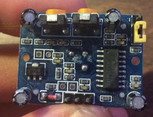

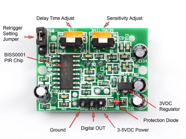

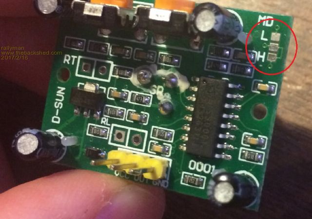

Posts: 2998
Posted: 02:25am 18 Feb 2017
OK - Two major things:
1: Looks like you need to set the jumper option in the top right hand corner (as in your photo) marked with H and L
Reading the data sheet, I would personally short both the lower two pads (i.e. H) to provide a continuos logic high level when movement is detected
2: The output is active high (note to others: this 'active level' is NOT determinedt by the jumper link mentioned in the above point). We have been supplying code that ONLY works on active LOW (see below for more info)
So, first you need to short out a jumper option.
THEN you need to change your code to work on a 'high' input to indicate motion.
Hope the above information helps you out
WW

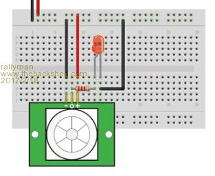

rallyman
Joined: 15/02/2017
Location: Hungary
Posts: 9
Posted: 03:34am 18 Feb 2017
thanks!
1) my sensor is default H
but I also have pirs with jumper:
So I have changed my code to pulldown version.
Now,it never gets any motion detected :(
I have also tried to short out the pir_out leg working like this:
This is stange, because I can never blink the led :(

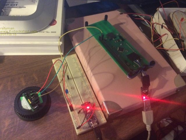

rallyman
Joined: 15/02/2017
Location: Hungary
Posts: 9
Posted: 04:22am 18 Feb 2017
OMG :(
I have create a setup wiht my arduino panel and it works fine :(
there is sg wrong with the GRN and 5V output on the PIC!
Now i have a setup where I get the GRN and 5V from the arduino panel via usb and I get the pir_out and led_pin connected the the PIC pins. Now all the codes and wires are working fine...
soon comes some picture
