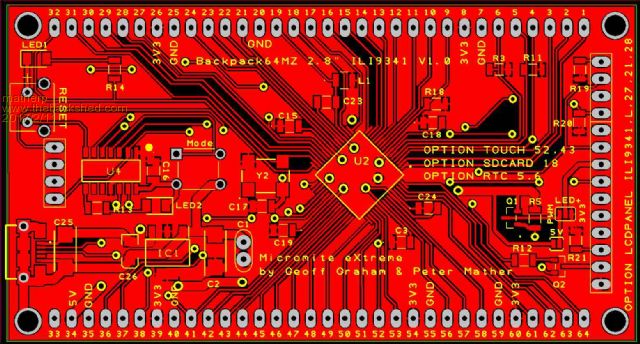

The question is what sort of PCB would suit? I've designed a 2.8” ILI9341 sized board as above and the prototypes of this are on order. Hopefully WhiteWizard will add this board to his portfolio but I'll release gerbers as soon as the design is checked out. Because the PCBs are comparatively small (93.5mm x 50mm) they are also cheap - USD23 for 10 including shipping to the UK.
The board is powered through the micro-USB connector which also acts as the console via a PIC16F1455 with the USB/UART/Programmer code installed. The PCB is on a 0.1" grid and can be plugged directly into a breadboard for connecting additional components. The 2.8" ILI9341 TFT display, if fitted, mounts over the top of the components on the board and provides the SDcard slot. Every pin on the 64-pin MZ is broken out in the expected order. The bottom of the PCB is silk-screened with full details of the special function uses of each pin as below.
Other than the console, there is no on-board functionality provided except for transistors to allow for PWM control of the TFT backlight.
SMD components are chosen to be easy to hand solder (1206, SOIC, 7x5 oscillator).

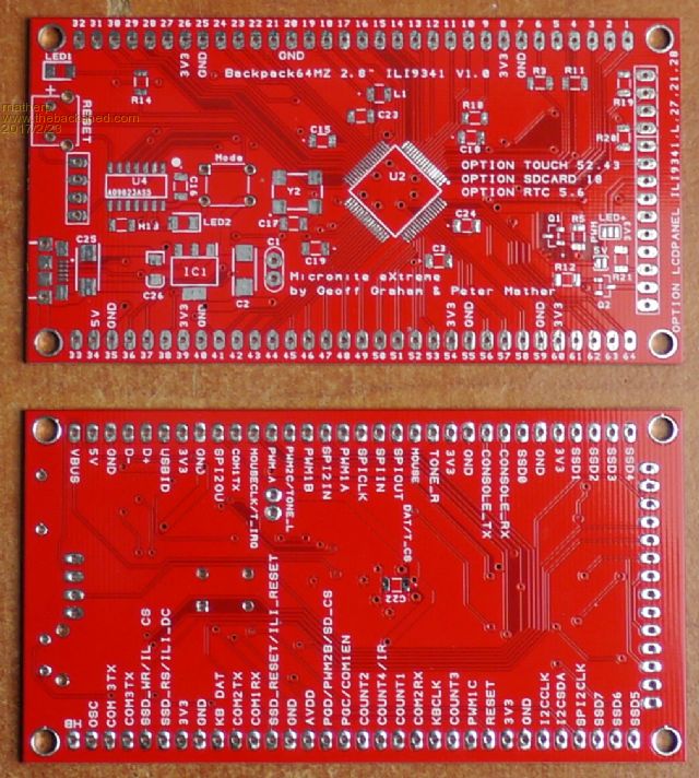

PCBs have arrived - just need to build one now

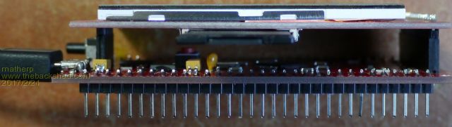

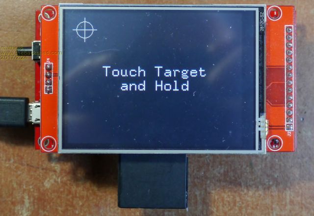

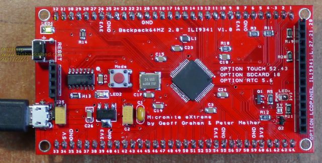

I like it when things work first time and don't need any changes
Contact WW if interested in a PCB
