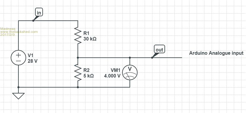

I think that is everything, this includes the voltage regulator to run it off the battery bank voltage. Only hardware change needed for different battery voltages is 30K resistor.
12V 15K
24V 30K
48V 60K

Here is the first part of the circuit

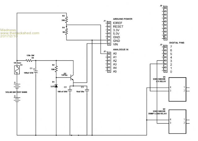

Looks like an interesting project. With the regulator to supply power to the Arduino, you may have to do it in a couple of steps to keep the voltage drop across the regulator down as 28V down to 5V leaving 23V across the regulator will limit the current you can draw without over reaching the power capabilities of the regulator. Maybe a 28V to 15V reg that then feeds a 5V reg?

I am going to use the same circuit as Oztules for the power supply in the Ozinverter control board. It has no problem delivering 5V from a 48 volt battery bank which is quite often up near 60 volts while charging.

Just you carry on with the Arduino. I will make one from your instructions.
I will point folk who ask me to here, most are absolute beginners, so don't worry about giving to much info, more info the better.
My philosophy .... keep it simple, make it robust, and keep it cost effective.
Posted: 02:41am 10 Feb 2017
Okay here is the full circuit diagram, hopefully there are no mistakes.
This should all fit on the prototyping shield as per post 1. However the 2 SSR's will be seperate and you will need to allow room for a heatsink for the TIP35c.
I will also include a Serial 2X16 LCD display in the code, but it will work just the same with no display.
I will work on the code and then it will be ready to use when you have built the PCB.
I have made a PDF of the circuit that wil be easier to read.
