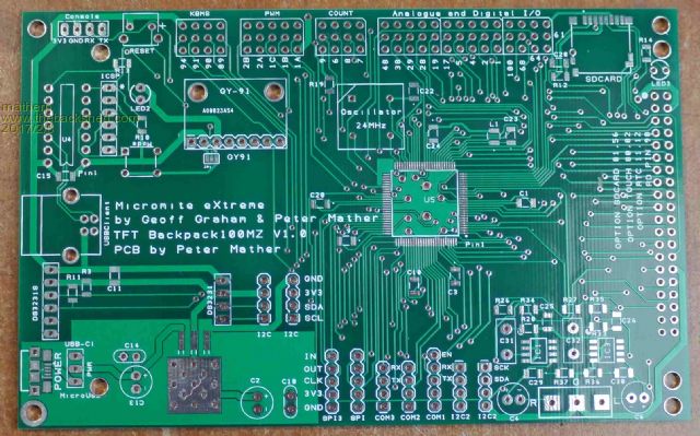

A new PCB for the 100-pin MZ is also in development. This includes a stereo amplifier to allow the Micromite to directly drive 4ohm and 8ohm speakers. The PCB is sized to fit a 5" SSD1963, the same as the Explore100, but also includes mounting holes for a 4.3" SSD1963 display

Awesome Peter..!! I love the dual display option..! Is that the GPS module hookup I see..? Nice... Is there a Kit for the PCB..?

I will hopefully be adding this MMX100 PCB to micromite.org as soon as testing is finished. Peter has had it just for a few days, and one is on its way to me hopefully receiving Tuesday . All components are here waiting to build this one .. .

Not available yet - but adding soon. Being a smaller PCB, it will be a cheaper PCB.
