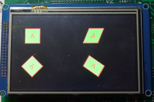

Probably not much use but an interesting academic exercise
This code snippet uses the "three-shear" method to rotate an image. The method works for angles between -45 and 45 degrees and is explained nicely here
It could be used to rotate text to specific angles, for example to draw a compass rose, and then position the images on the screen as part of drawing a fixed background.

Thanks Peter for giving good examples on how to use the new features we have been given..! I had no idea that the BLIT function could be used in this way... Never herd of "tree shear" or some of the other methods you have used in the passed... I love your knowledge base of maths and how you share code and much of your time..!
Big "tip of the hat" to you fine Sir..!!
