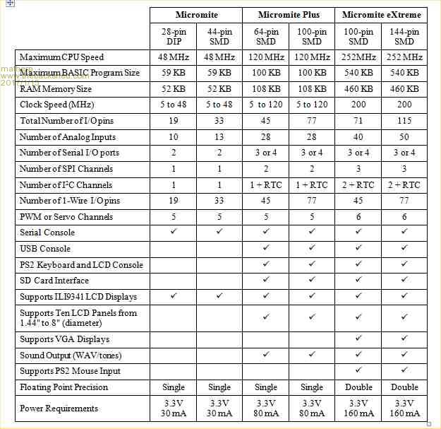

Posted: 10:00am 15 Jan 2017
Plasma,
You are not alone. It's amazing how lost one can get by not following TBS for just a few months.
Peter, the matrix is exactly what has been needed (very well done), and I would suggest including this in each of Geoff's MM manuals. Showing the complete range up to the eXtreme even in the manual for the basic 48 MHz MM.
A similar matrix showing available boards' principal features and their sources would be very helpful as well.
I could do such a board matrix if no one else comes forth from the many who know the boards better than I do.
Hank

Posted: 10:49am 15 Jan 2017
  Quote  Peter, the matrix is exactly what has been needed (very well done),
Not me, Geoff was the author, I just copied it from the Micromite eXtreme manual

Posted: 02:28pm 15 Jan 2017
Then Geoff has done a nice job detailing the features.
I had downloaded the X manual and only so far looked at a few pages so completely missed the chart.

Posted: 03:16pm 15 Jan 2017
  robert.rozee said
  Grogster said  MM2 28-PIN: For simple tasks, and entry-level stuff, and for initial learning about MMBASIC and teaching yourself the language and how to use it. Very cheap, and will run on batteries. Ideal for classroom experiments with it's DIL size. The only MM available in DIL package - all the other versions are QFP SMD packages.
with 50k of RAM and 60k of flash available, i'd not be so quick to relegate the MX170 micromite's to a 'simple', 'entry-level' role. they represent an extremely capable micro-controller that is well suited to the vast majority of tasks, and may well outlast (and outsell) the bigger, faster, more power-hungry and expensive micromite variants.
You are quite right.
My post was only to very simply state what flavours their are. Certainly not raining on the 28's parade. Apologies to anyone who thought I was saying it was not useful. That's part of the problem with very brief summaries of things!
@ matherp/Geoff - excellent chart. I came across that in one of the latest downloads, but did not see it prior to making my post. This chart is way better then my attempt to explain things, as it shows EXACTLY what the differences are.

Posted: 05:25pm 15 Jan 2017
+1 for the chart from me too, thank you again Geoff and Peter.
I think a row in the chart showing the current version of MMBasic would be useful too, especially for the Maximite and MX150 versions. The versions for the MM2 and later ones could have an asterix to note: "still in active development; check Geoff's website for updates" or some-such.
Also the manuals that are relevant to each would be a handy addition, these have changed a fair bit - I mean mainly the name + necessary additions like the Hardware and Addendum manuals.
Greg

plover
Joined: 18/04/2013
Posts: 306
Posted: 01:07am 16 Jan 2017
The "spreadsheet" picture great. It looks like a spreadsheet or is it a table in in the PDF manual?
Is it possible to get a spreadsheet copy of this for download, then extra custom details can be added by the user.

Posts: 2552
Posted: 05:44am 16 Jan 2017
here is a .ods spreadsheet of the data, with columns added for mono maximite and colour maximite. a note at end giving MX150 RAM and flash specs.
some details still need filling in, and i suspect the numbers for 1-wire pins for MZ2048 devices are wrong.
actual current consumptions for devices at different clock rates would be useful if anyone cares to perform a few measurements.
2017-01-16_154410_micromite_specs.zip
rob :-)
Posts: 2981
Posted: 01:36pm 16 Jan 2017
Hi Peter, All,
Just a note, as I have been compiling a list for the extreme 100 (I am looking at doing a MuP-ex100).
The extreme in the table above lists 71 IO pins.. From the table I have it `can' be 75 if PS2 k/b and Mouse is not required. So I suggest it be amended to 75.
For those interested here is the spreadsheet I have done for the 100pin extreme
2017-01-16_233544_PIC32MZ2048EFH100.pdf
