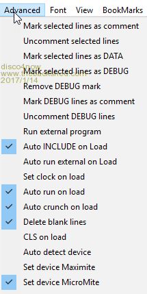

Joined: 18/12/2014
Posts: 1151
Posted: 12:28pm 14 Jan 2017
Hi Lewis,
Make sure you have the Auto Crunch on Load and Delete Blank Lines checked under the MMEdit Advanced menu. This strips out any comments and makes what is loaded smaller.
I just unchecked them and reloaded. I got the error below , which is what you got before I think.
So I think both errors are about the code being too big when the comments/blank lines are included.
> RUN
Flash:
87K (87%) Program (1656 lines)
4K ( 3%) 5 Embedded C Routines
9K (10%) Free
RAM:
71K (66%) 110 Variables
0K ( 0%) General
34K (34%) Free
[1305] CSub sdcard '64-pin or 100-pin
Error: Internal fault (sorry)
The MMEdit settings
Gerry
F4 H7FotSF4xGT
lew247
