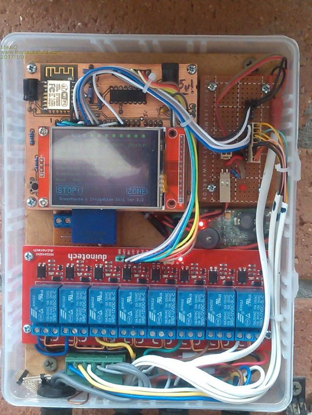

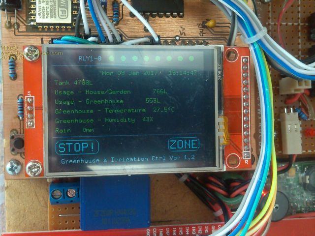

Just commissioned my latest project , this one is set up as a an irrigation controller for the Garden and Greenhouse but it could be used for other timed repeatable tasks.
Mine has timed tasks for 2 garden areas and Greenhouse, misting for greenhouse, Exhaust fan for greenhouse, 2 water flow sensors and 10000 ltr tank level sensor.
Timed tasks can be up to 5 On/Off cycles per day/area, days of the week etc.
Total water usage monitoring, usage per day exceeded per day will trigger override.
Configuration Set up is via Wifi , sent by complete file or by single line.

That is very impressive, good job!! Is that some loose pins I can see in the bottom left hand corner of the first pic?? If it is you might want to get them out of there, would hate to hear you had a short and ruined some of that great work.

Busa, Yes they were hangover from during testing, some tidying up to do! Thanks.
