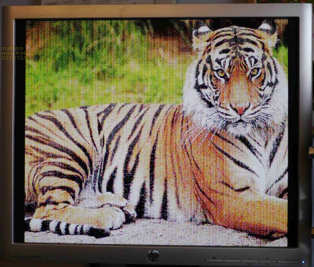

Attached is a photo of our friendly tiger converted to RGB111 using XnView set to do 8-colour Bayer dithering displayed using the VGA driver. Loading the image takes just under 1 second.
2016-12-08_114326_tiger640.zip

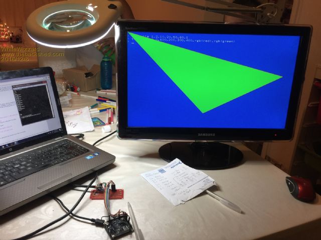

Hi Peter,
Getting closer to testing.
Currently have the 24MHz swapped onto the PCB (i.e. replaced the 12MHz oscillator) and have the Beta successfully loaded and running.
About to build the video circuit but can't find any spare diodes so need to pull them from something.

Posts: 2998
Posted: 06:40am 08 Dec 2016
SUCCESS
Few things to feedback:
1> I had a loss of the RED signal which I assumed was a loose wire. However, nothing was obviously 'broken' so did a reset and I had the 'RED signal back! Not been able to re-create this, but will keep an eye out for this one.
2> The Triangle command is fantastic. However, can I suggest an extra parameter to match the other command (such as BOX, circle, etc) in that there is a 'line width' parameter.
3> (One for Geoff maybe). I use the OPTION LCDPANEL CONSOLE 1,RGB(...),RGB(...) to set the default colours of the console. Upon a power-up, or a reset, the screen is cleared to black rather than the background colour set in the OPTION LCDPANEL CONSOLE command. Note that any text drawn (such as the welcome message upon power up) is correctly drawn with the foreground/background colours; however, as I mentioned, the rest of the screen is black.
The GUI TEST LCDPANEL draws the circles amazingly quick
Will keep testing . . .

  Quote  If you draw a triangle with lets say a red 'outline' and a green fill and on a black background; then draw another triangle with all the same 'co-ordinates' but this time with a black 'outline' and a black fill, then I would expect the triangle to 'disappear.
This is an issue Geoff has already picked up on. I'll post a fix in the next beta.
  Quote  3> (One for Geoff maybe). I use the OPTION LCDPANEL CONSOLE 1,RGB(...),RGB(...) to set the default colours of the console. Upon a power-up, or a reset, the screen is cleared to black rather than the background colour set in the OPTION LCDPANEL CONSOLE command. Note that any text drawn (such as the welcome message upon power up) is correctly drawn with the foreground/background colours; however, as I mentioned, the rest of the screen is black.
I should be able to fix this - I'll have a look

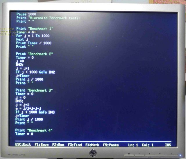

  Quote  7> Now look at the MEMORY command as it was typed and it has cropped the last row of PIXELS
This could be your screen not displaying the full 480 lines. My "old" 1280x1024 screen works perfectly - rock solid picture no missing lines. My "good" Dell screen gives a less stable image and the position is one line off.
In the next release I will include a fudge factor to allow the vertical position to be adjusted.
Try BOX 0,0,640,480 to see if you can see the complete outline
