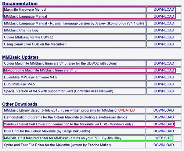

Supercool
go here for info on the mono Maximite
http://geoffg.net/MonoMaximite.html
and go here for downloads of the mono Maximite firmware and the serial port driver for the PC
http://geoffg.net/maximite.html#Downloads
The following is an image of the downloads on that page. The ones highlighted in red are essential and the one in green is very useful but may be too much until you get more familiar with the Maximite. If I've missed anything I'm sure that someone will come in and advise.
