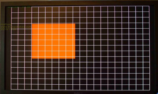

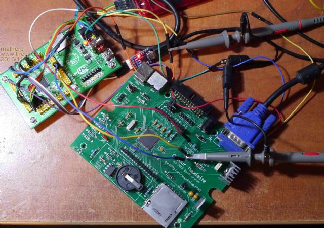

Using an unpowered Maximite to provide the VGA physical connection and diode clamping.
Picture is stable and clear full 640x480 resolution (8-colour)
Lot of work still to integrate and still a few funnies (green line at top left of image)

  Quote  Are you using software SPI ports for that
It uses 3 SPI ports (out of 6 on the 100-pin MZ) and 3 DMA channels (out of 7, 1 is also used by USB). In addition it uses 1 timer (out of 9) and 1 output compare channel (these are used for PWM, out of 9). The working code is about 15 lines in the timer interrupt routine which is called every line (31.775 KHz) everything else after set up is done by DMA independent of the processor.
The code is a variant of that used by Geoff in the Maximite. There seem to be some significant differences between the way the MZ works and the old MX795 so it took me a day of playing to get it all working.
The next step is to integrate VGA as a driver into the firmware

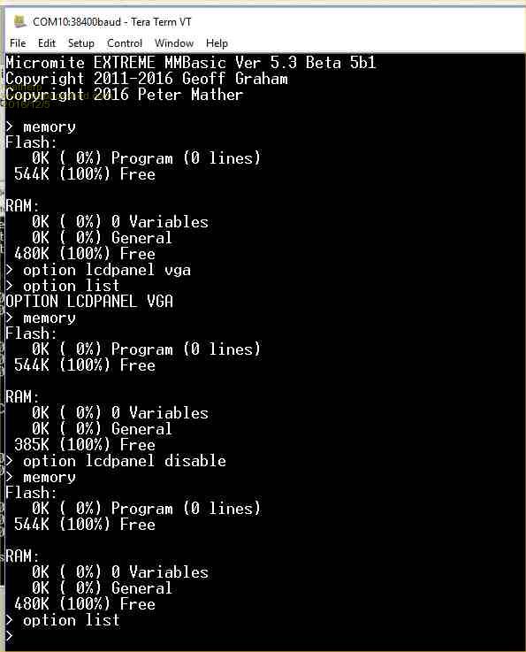

OPTION LCDPANEL VGA
after that it will be able to be used transparently in exactly the same way as a SSD1963 or ILI9341 display so all the graphics commands should work. The only difference is that VGA is only 8-colour. The code uses a frame buffer in the MZ memory but that only reduces the user available RAM by about 100K (from 470K). When the VGA driver isn't loaded then there will be no impact on memory or available pins.
The wiring and number of pins needed will be exactly the same as the Colour Maximite except that I don't intend to implement composite video so that saves a pin. I will probably reduce the number of user SPI channels from 4 to 3 and there will be some pinout changes to accommodate the new functionality but otherwise there will be no impact on the previously published EXTREME code.
VGA will only be available on the 100-pin MZ and not the 64-pin variant

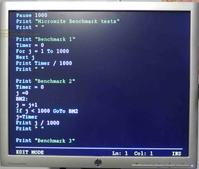

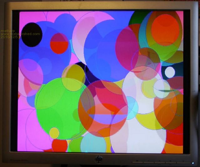

Posted: 05:30am 05 Dec 2016
  Quote  (Any more teaser photos yet Peter?)
Demo video
Posts: 2998
Posted: 06:45am 05 Dec 2016
WOW - that is FAST!
Is that a 'hacked' GUI TEST, or have you got several/all the general graphics interface working with the MM firmware?

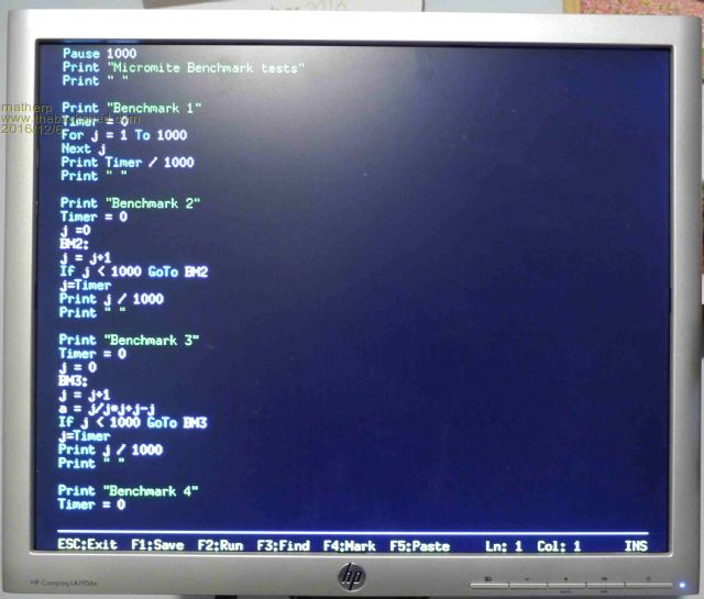

Posts: 12185
Posted: 07:05am 05 Dec 2016
  Quote  have you got several/all the general graphics interface working with the MM firmware?
Yes - everything working except the console - that is next on the to-do list.

IF Load Image is also working- ow does it deal with converting RGB to the limited number of colours? Or put another way, will it still load a .bmp if you create the .bmp file in the 8 'correct' colours?
I assume this is still 640x480? What size characters are you thinking of using for the editor? i.e. how many columns & rows do you think is achievable to make a nice readable Editor display?
