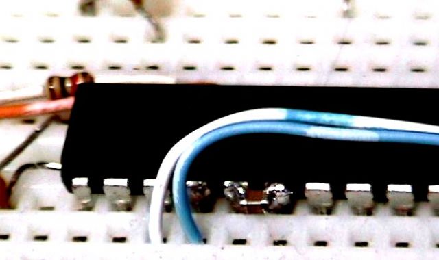

On page 4, VREF you describe directly soldering the 10uF cap onto
the leads of the DIP chip. I have done this to all my uMITEs.
I have a picture of this:
Feel free to add this image to your document if you like.
redrok
