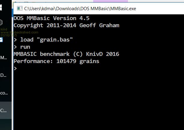

Just for the fun I ran MMBasic on my i7-6700HQ/2.6GHz :)
Had to modify a tiny bit the variable declaration statements (only!) in order to make the program compatible with the older syntax parsing.
Here is what I got...
2016-12-05_131329_grain.zip
