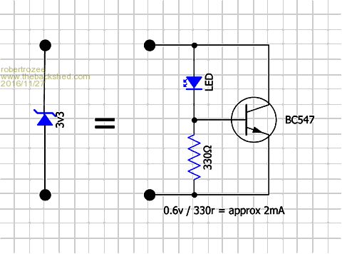

Posts: 2552
Posted: 05:25pm 26 Nov 2016
because it is a shunt regulator, the load (zener diode, pic32, or some combination thereof) needs to always be drawing 60mA. the only way to decrease this is to increase the values of the three 100 ohm resistors. but if you increase the values of the 100 ohm resistors, then you risk not having enough current to power the pic32 during programming.
i chose 60mA as being a safe compromise: microchip suggest the target should draw no more than 25mA, i read somewhere that the pickit2 can supplky at most 50mA, and the usb port is limited to 100mA in total.
any zener diode between 2v7 and 3v9 should be fine, or you can use a string of 4 or 5 silicon diodes in series. or, if you must, you can use an 'amplified zener' circuit:
rob :-)
