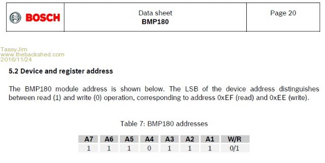

- how does one know that the BMP180 address is &H77? (TassieJim's code to read BMP180 temperature and pressure)

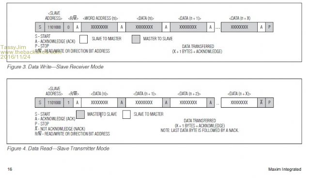

- how does one know that the RTC address is &H68? (Geoffg's code for SuperClock)

Posted: 08:06pm 23 Nov 2016
Sorry, I missed that bit.
For the BMP180
My version of the data sheet:
The binary 1110111 is the same as 77 hex
The data sheet also talks about EE for write and EF for read.
That's just adding a zero or one onto the end of the binary number
11101110 = EE = write
11101111 = EF = read
The Micromites add the read or write bit as required so we stick with the 7 bit address.
With all I2C addressing, you need to work out if the datasheet is using 8bits (with the direction included) or 7 bits.
Fortunately, most data sheets show the address in binary at some stage so it's relatively easy to sort out.
If you have Windows10, the calculator in programmers mode is handy for converting to/from binary
Posted: 08:25pm 23 Nov 2016
Here's the section of the DS3231 datasheet
1101000 binary = 68 hex

Posted: 10:13am 24 Nov 2016
Jim, Thanks (again).
I'd stared at page 20 of the BMP180 datasheet for ages (several times) and not made the link between it being a binary No. that had been converted to hex (I was happy with the hex addresses given on page 21 so had not queried them).
Thanks to your explanation I now know to think binary and hex.

Jim is quite right about the datasheets - they will contain all the info you need but it might be a bit cryptic... learning to read them is a bit of a dark art and they all vary in style a bit so you might have to hunt around and "read between the lines". The DS3231 is a good example; nowhere does it say "the device responds to address....." etc. you just have to glean that info when you look at the timing and data format diagrams. Cute. You can always ask here
