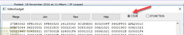

When you convert to MMBasic select the CSUB option instead of CFUNCTION
and you will get something like below.
CSUB set_pinout

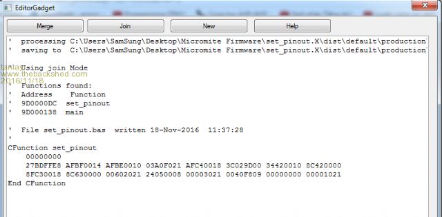

Thanks Gerry help me.
I'm convert using CFGEN.EXE but I don't see choose CSUB or CFUNCTION.Software CFGEN.EXE I download in forum.
Thanks.

And convert using CFGEN.EXE
program MMedit:
OPTION EXPLICIT
OPTION DEFAULT NONE
cpu 40
pause 50
CONST SDA = 24 'SDA of FT6206
dim i% = set_pinout(24)
do while(1)
loop
end
CFunction set_pinout
00000000
27BDFFE8 AFBF0014 AFBE0010 03A0F021 AFC40018 3C029D00 34420010 8C420000
8FC30018 8C630000 00602021 24050008 00003021 0040F809 00000000 00001021
End CFunction
When load program in to microcontroller then error
Thanks all
Edited by tantay 2016-11-19

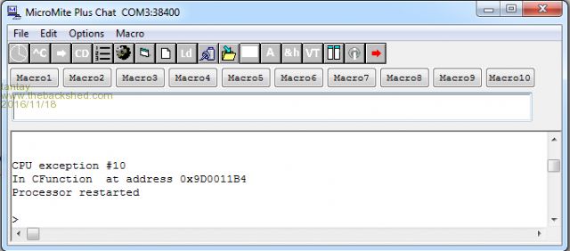

Posted: 10:16pm 17 Nov 2016
Hello Matherp and Gerry
I'm try on write I2C software talk with FT6206 touch controller. I refer one article in forum but when convert to MMbasic then Error and i don't talk with FT6206
this is project
2016-11-18_081543_CapTouch.X.zip
The optimization level is set to 1 and add "-fPIC -mno-abicalls" under "XC32(Global Options)"
Help me
Thanks all

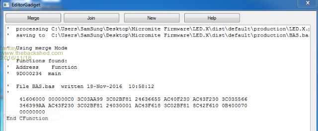

Posts: 12185
Posted: 12:00am 18 Nov 2016
Your issue is that you can't call one routine from another. Do read all the tutorials to see how I do it.
All calls must go through "main" which than acts as a switch to call the other routines. CFGEN is then used in "merge" mode to create a single CFunction with a single entry point.
