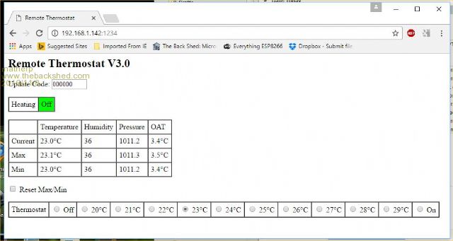

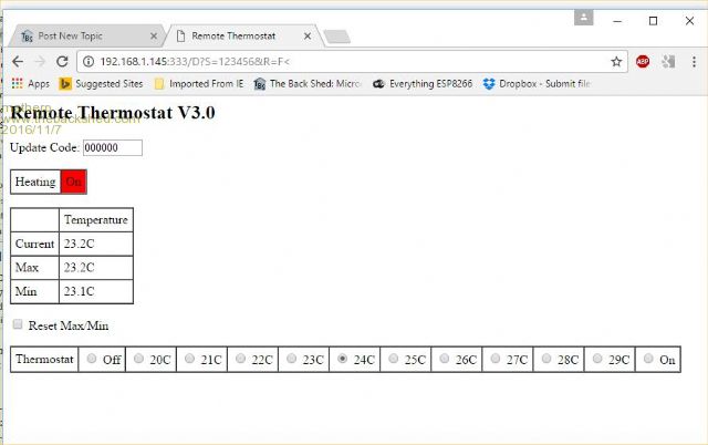

There are lots of versions of firmware for the ESP8266 but the simplest is the basic "AT" firmware provided by the chip maker Expressif. The firmware is included in the SDK (1.5.4.1) and can be flashed with their own flash download tool. Details for how to the flash the chip are in the documentation
Although there are easier ways of creating a webserver, using for example ESP8266Basic, the AT approach is easy to understand and seems very reliable (tested on Chrome, Edge and IE11).
The attached code is for a simple remote controlled thermostat but contains all the elements needed to set up the ESP8266 from "as-flashed" state and connect it to a router.
HTML requests are particularly verbose so I'm using a few of Geoff's excellent long string CFunctions that he includes in the Micromite distribution to allow strings over 255 characters to be parsed and/or printed
The key routines in the code are: Command, SendText and EndSend.
Command sends an AT sequence to the ESP8266. It includes a timeout and optional search string. In general AT commands indicate success with "OK" and failure with "ERROR". However, some AT commands report OK before completing execution so the optional search string allows you to wait for something other than "OK" to indicate completion. Command returns 1 if successful and 0 if an error or timeout has occurred. An example of using the function is:
[code]IF NOT Command("AT+RST", 10000, "WIFI GOT IP") THEN 'reset and check for valid connection[/code]
This resets the ESP8266 and waits for up to 10000 msec for the string "WIFI GOT IP" which indicates that the ESP8266 has connected to your network.
If this command fails the attached code includes all the commands needed to connect to the network from scratch
SendText does what it says. It sends a text string to the network. Typically this would be some HTML.
EndSend flushes the output buffer and sends the completion indicator which allows the page on the browser to complete.
In the attached code just change the constants
CONST SSID$=quote+"mySSID"+quote
CONST SSIDPassword$=quote+"mySSIDpassword"+quote
to attach to your router.
The code also includes a generic HTML request parser which should be generally useful

nasi
Joined: 08/07/2015
Posts: 16
Posted: 04:27pm 07 Nov 2016
Hey matherp.
So that web session I see above is that what you are accessing on the ESP8266 unit.
Gee I might skip straight to that instead all these other crazy things I had in mind.
It looks alot simpler for remote access of my controlled resources.
Might take me a bit to learn those CFunctions though.
Cool
Richard

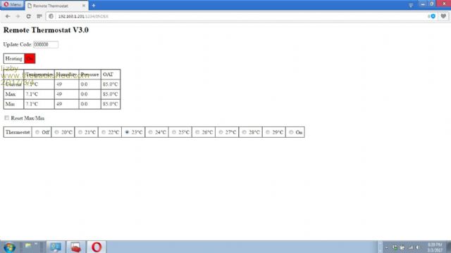

Posted: 07:33am 03 Mar 2017
In trying this very nice piece of software I was stumped for a while with this error while running on an Explore64 with MMBasic 5.3b:
Page$=UCase$(parsehtmldata$(nparams))
Error: Invalid syntax
I finally figured out that "Page" is now a command. Changing all instances to "pageX" fixed that.
Now I have an error sending the html back to the browser.
[code]
Opening COM3
Reopening COM3
Getting IP:
IP: AT+CIFSR
+CIFSR:STAIP,"192.168.1.201"
Connected
nparams: 0: |INDEX|
ERROR : AT+CIPSEND=0,173
ERROR : AT+CIPSEND=0,185
ERROR : AT+CIPSEND=0,238
[/code]
The first 6 lines plus the line after "Connected" I added for diagnostic purposes. Other than removing the calls to the BME280 (and setting appropriate values for data from it), I didn't make any changes to the parsing code.
I'm connecting with a ESP-001. The program says it has connected. In response to my browser request of http://192.168.1.201:1234/INDEX (which the line after "Connected" indicates id being received), I get "The 192.168.1.201 page isn’t working".
Anything to try to get past this sending error?
Edited by lizby 2017-03-04
Posted: 03:42pm 03 Mar 2017
This is perplexing. It works for me with IE, Opera, Safari, but not with FireFox or Chrome.
Edited by lizby 2017-03-05
Posted: 06:33am 04 Mar 2017
Ok, it was a rendering issue. Firefox considered the page to be text, and showed the raw html.
Chrome sent back to the ESP8266 that what had been sent to it was invalid, so I got the messages, "ERROR : AT+CIPSEND=0,239".
IE, Opera, and Safari figured it out and rendered the raw html appropriately.
Adding this line at the beginning of sub drawpage made it so that it works in all 5 browsers:
sendText "HTTP/1.1 200 OK"+crlf+"Content-type: text/html"+crlf+"Connection: close"+crlf+crlf
