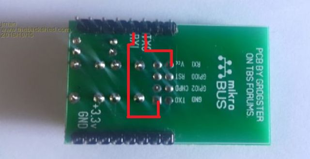

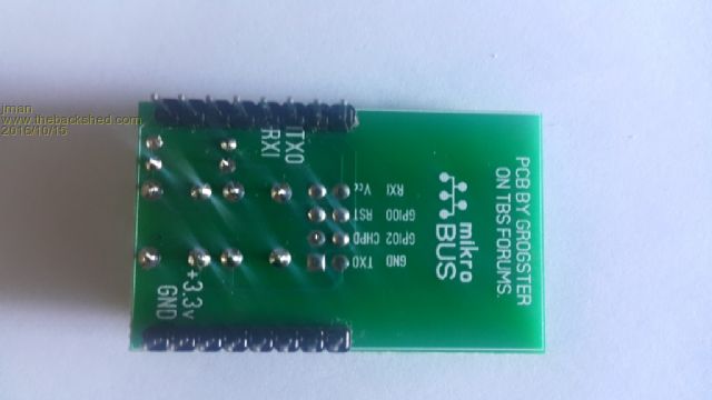

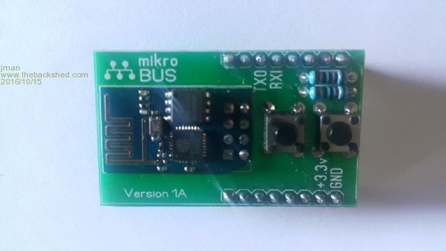

To make it easier to use WiFi with the E100 Grogster
kindly designed a PCB for me that uses the mikro BUS standard
to interface to an ESP-01.

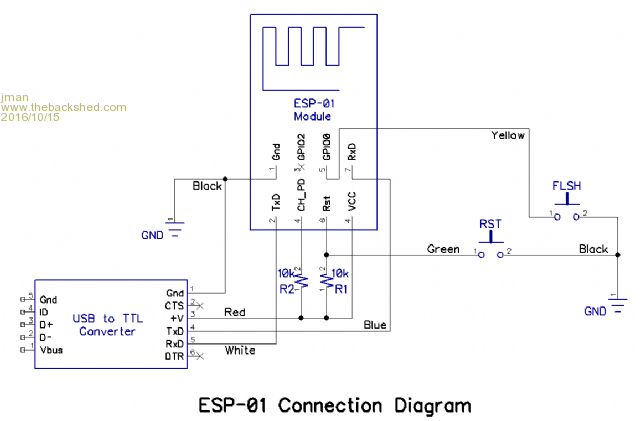

The buttons are to make updating the firmware easier
and can omitted if you don't intend to update the ESP-01
firmware. To update the firmware use the following circuit
To use the module on the E100 you need to make the solder jumpers
labelled click TX/RX this uses COM3

Nice idea
My only comment would be to add holes for a 100uF tantalum and 0.1uF ceramic across the power rails. The ESP is notoriously sensitive to power supply and works best with a big "tank" capacitor as close as possible to the module.

Version 1B?
You could easily add those caps on the bottom side I guess - there's plenty of room in between the female headers on the Click sockets, for the caps to exist on the bottom of this module.

A suggestion regarding your E100 board
If you added a DHT22 and a 4K7 resistor and connected it to the PWM pin, then the board could be used as a weather station for the E100
It could pull the outside data off the internet and display it and the DHT22 could display the internal room temperature and humidity
I did actually design a similar board to go with my weather station once it's all working properly, but your board is much better as you included the programming input for the ESP8266 which I had forgotten aboutEdited by lew247 2016-10-16
