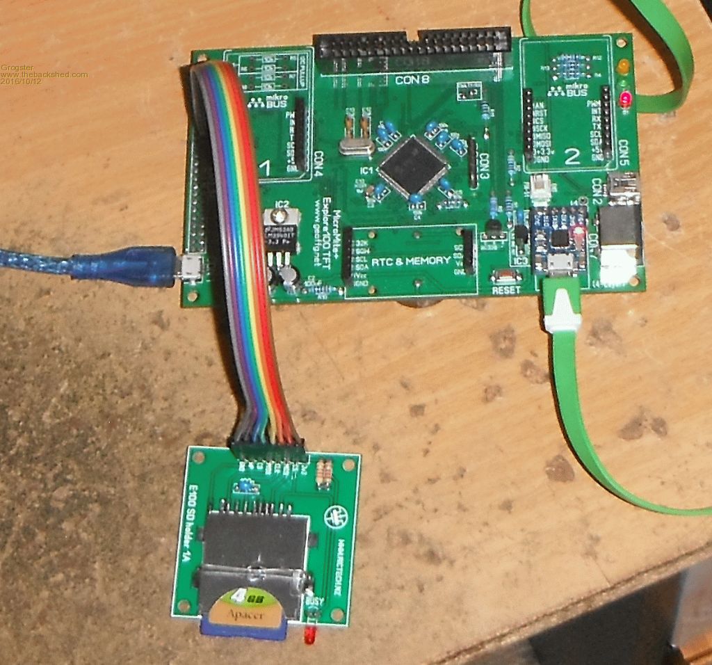

Hi folks.
This is something that has been requested a few times recently, both here on the forums, and in PM's to me and via my website: "Where can I get/when can I get an add-on SD card for the E100 board?"
Well, I finally managed to assemble and test the 1A prototype unit tonight, and I am happy to report that it works fine.
The image above is using one of the 1A prototype E100 boards(as in the images in the SC articles), but the pinout and tracking for the 1B is identical to the 1A with respect to this connector.

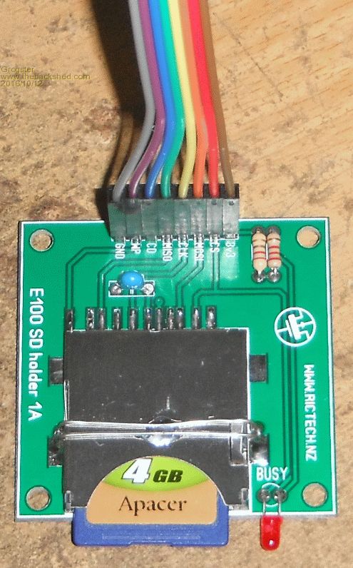

"BUSY" LED lights while the SD card CS line is low, so is a quick and easy way to show SD card access is taking place. This little board has the 2R2/100n RC filter on the 3v3 power supply to the SD card, and I have been swapping cards all night on it thus far, and the E100 has NOT ever rebooted by itself when this was done, like in some of the E64 modules which do that with the supervisory IC in place.
This 1A E100 board also has a supervisory IC.
I am likely going to be selling these on the website soon for about US$10 a kit(including airmail to anywhere on the planet) - which will include the PCB, SD-card socket, resistors, cap, LED and pin-header.
This particular SD card socket can be had easily on eBay, but they don't have any way to anchor the socket to the PCB. The socket relies on it's pins being soldered to the board to hold it there, along with perhaps a snug-fitting front bezel or something. I have added extra holes so you can give the socket a seatbelt, and also by soldering the metal shield to the PCB too for additional support.
The 1A of this add-on board was not PERFECT in that the locating dowels on the bottom of the socket did not match perfectly what I had designed, so I had to cut one of them off. Any 1B version of this board will fix that, and probably shorten the SMD pads for the socket pins too, as they are too long for my liking.(however, that does no harm)Edited by Grogster 2016-10-13

Hi Grogster The add on SD card I picked up from you yesterday took only a few minutes to build and once I had the right OPTION SDCARD 52,53, 17 command for my E100, the previously uncommunicable 7" SSD1963 immediately responded to FILES and other SD card commands. Thanks. It proves to me that the SD slots on some of these LCD screens are not always totally functional, my 5" works fine. You are right in that the smaller SD card capacity i.e. below 16M and below work best, I have had no reponse from a 64M card, although all had the same Fat32 format and files loaded. Problem SD card revived and now I can locate the SD card in a more convienient and accessible position!
