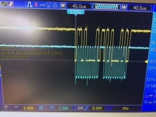

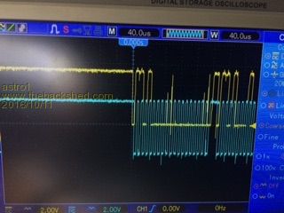

Battery hooked up, diode removed.
RTC gettime with DS3231 looking at data / clock. Not working.
RTC gettime with DS1307, same pins on explore100. Working.
I did try swapping the data and clock around. Gotta be something I'm doing wrong.

If you plug the module into the E100 as in the picture and it doesn't work then, given you can run a DS1307 in the same connections (prove it at both ends), the DS3231 must be faulty. They just plug in and work once the OPTION command is set - there is very little scope for getting this wrong in any way
