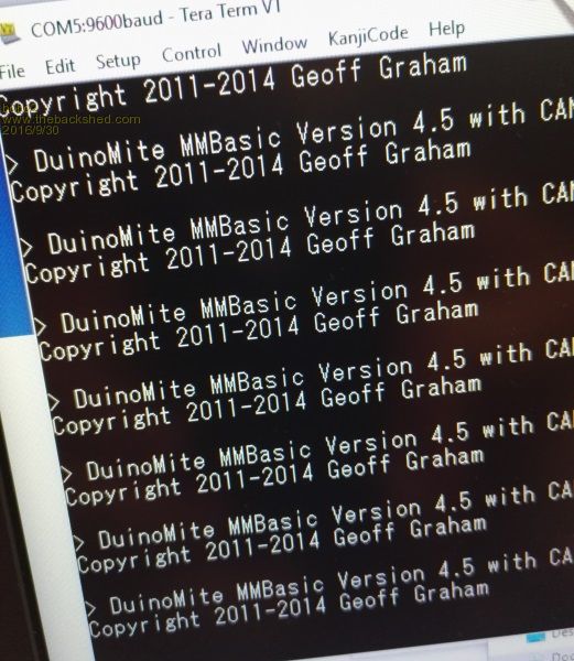

I was doing a test on the duinomite with a realtime clock and left the duinomite on for 2 days... and then unplugged it to see how long it would work on the small li-ion battery.
After this the duinomite has started showing the copyright text every second. It is not restarting, since if I write commands (for example print pin(21)) I get results... it is just that the copyright text is showing every second and disturbing the output of the command.

Here is an image from it...

It could be because it is detecting a fresh USB connection every second. Try disconnecting the USB and see if it stops.

Yes, this is it!
I think it is the driver or port on my laptop that has gone bad - I tested with different cables, but no difference, and then I tested with another laptop and there was no problem at all...
I will have to figure out if it is the driver or something else that is wrong.
