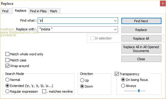

Then we need to convert this into valid data statements. In Notepad++ a single replace will do most of the work
giving:
I will add the option to MMEdit. It's not very different to making code into comments so it should be simple to do.
