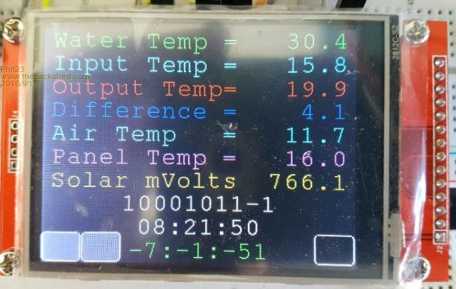

Hi Everyone,
Can anyone see where this little bug is coming from.
I've seen it a few times since some code changes;
Not sure when I introduced it.
The Green value at the bottom of the screen;
It's last Pump Run Time.
It was showing -7:-1:-51 this morning, & I've seen it a few times over the last week.
Not sure if it's always the same value or not.
I stopped the code & checked a few variables:-
[Code]
> Print PumpOnTime
14:34:27
> Print PumpRunTime
-25311
>[/code]
Any thought's on where is happening?
Showed a valid time last time I looked at it last night, and shouldn't update while the pump is stopped.
On pump restart it should reset, which it usually seems to do Ok.
Phil.

  TassyJim said   You haven't taken into account that the 'time' resets to zero at midnight.
Hi Jim,
I figured the midnight roll-over wouldn't ever come into play, as the pump will never be started on solar in the dark, so start time & current time should never fall either side of midnight.
The Pump Start condition, should not exist until after about 8:30am, When SolarVolts are above the threshold & minimum panel temperature is met. Then it's started by the 2nd option of the IF block.
(That's what PumpIf=xxx is for, just monitoring & debugging; so I know which if statement is true; that's the "-1" above time on the LCD).
That's when PumpOnTime is set along with PumpStat="Running".
It will then only update PumpRunTime if PumpStat=Running.
When I checked variables after stopping the code, the PumpOnTime was 14:34:27, 52440 Seconds AM.
Sunday afternoon. The photo is Monday morning. So PumpOnTime didn't change overnight.
Runtime=Time-PumpOnTime, so the value for PumpRunTime was last calculated at 7:32:09 AM this morning, 27129 Seconds.
The punt should not have been running then, as the panel would not have heated to 2° above water temp.
Unless the water sensor returned an invalid reading.
But if it did start for that reason, it should have reset PumpOnTime.
Phil.
Posted: 07:54pm 11 Sep 2016
So the problem is with your PumpOnTime, not PumpRunTime.
Time-PumpOnTime = 27129 - 52400 = -25311
You need to work out why your PumpOnTime didn't change when the pump started, or why your "Running" didn't change when your pump stopped.

Think possibly this statement could have been True when all the ones above it were false.
[Code]
Else If (TmpOut-TmpInp>TmpDif) And PumpRuntime>600) Then 'Keep Pump Running while its heating
PumpIf=4
PumpStat="Running"
Pin(PinPump1)=0
Led2Colour=RGB(Red)
[/code]
That could have set the pump to run once the first IF statement became false.
TmpInp & TmpOut don't give valid readings overnight, with no water flowing.
TmpInp Sensor is mounted low near the concrete.
TmpOut Sensor is right up neat the top or the tub, so it's fitting is in much warmer air.
There's some graphs in this post that shows sensor readings overnight.
Phil.

Posted: 11:48am 12 Sep 2016
Thanks all,
Think the 4th test of the if statement is the error.
If all above it return false, it could incorrectly return true.
[code]
'====================Start Pump & Light Red LED if conditions are met
Sub SetPump
If PumpStat="Running" Then PumpRunTime=TimeSecs(Time$)-TimeSecs(PumpOnTime) 'Update PumpRunTime Value
If SolarVolts<SolarMin Then 'Test if Solar is Below Daylight Level
PumpIf=1
PumpStat="Stopped" 'Turn Pump Off
Pin(PinPump1)=1
Led2Colour=RGB(Gray)
Else If (PumpStat="Stopped" And SolarVolts>=SolarThres And TmpPan-TmpCur>=TmpDifPan) Then 'Test Solar and Panel Temp then Start Pump
PumpIf=2
PumpOnTime=Time$ 'Reset Pump Start Time
PumpStat="Running"
Pin(PinPump1)=0
Led2Colour=RGB(Red)
Else If (PumpStat="Running" And PumpRunTime<600) Then 'Keep Pump Running for Minimum 10 Minutes
PumpIf=3
PumpStat="Running"
Pin(PinPump1)=0
Led2Colour=RGB(Red)
PumpIf=4
PumpStat="Running"
Pin(PinPump1)=0
Led2Colour=RGB(Red)
Else If (TmpOut-TmpInp<TmpDif) And PumpRuntime>600) Then 'Stop Pump if not heating & minimum Runtime met
PumpIf=5
PumpStat="Stopped" 'Turn the Pump Off.
Pin(PinPump1)=1
EndIf
End Sub
[/code]
It be correct it should only return true if the pump is already in the running state.
The correct test should be:-
[Code] Else If (PumpStat="Running" And TmpOut-TmpInp>TmpDif) And PumpRuntime>600) Then 'Keep Pump Running while its heating
PumpIf=4
PumpStat="Running"
Pin(PinPump1)=0
Led2Colour=RGB(Red)
[/code]
Lol
I was working well as it was on most days.....
Particularly as it's been a bit cloudy of a morning since my last change to the code.
That meant SolarMin could be reached, then fall below it's level again with the clouds.
Result would be that the pump briefly turn on then off again after a short period.
On a clear day Solar volts would continuously rise, resulting in the pump running indefinitely.
Lol,
It's been nicely cooling my water on some mornings, either for a brief period, or just continue for the hour or more till it actually began heating.
Phil
