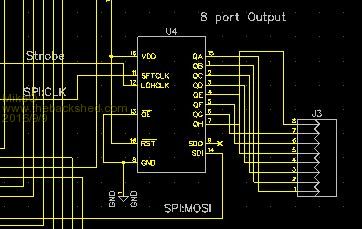

Hi, DRK posted this thread
I have some done some early testing for an upcoming project using a single 74HC595B chip. Schematic and DRK code changed a bit to do testing.
'SPI-16IO.BAS
'16 I/0 POINT HANDLING BY SPI
'2016.03.09--MM-V5.1
'DRK V1.0
'16 OUT: 2*HCF4094 16 IN: 2*MC14021 - BOTH ARE SHIFT-REGISTERS
'======[ INITIALISING ]================================================
OPTION EXPLICIT
OPTION AUTORUN ON
DIM K1,B1
CONST STRB=24: SETPIN STRB,DOUT:PIN(STRB)=1 'CONFIGURE DISPLAY LATCH PIN
'INP TO OUTP - UNCOMMENT NEXT 9 LINES
'DO
'SPI OPEN 500000,0,16
' PIN(STRB)=0
' PAUSE 1
' B1=SPI(0) 'READ FROM IN-SHREG TO B1
' K1=SPI(B1) 'B1 CONTENT WRITE TO OUT-SHREG
' SPI CLOSE
' PIN(STRB)=1
'LOOP
'0.5 SEC 16 BIT OUTPUT TOGGLE
DO
' K1=K1 XOR 8192
SPI OPEN 500000,0,8
PIN(STRB)=0
PAUSE 1
k1=k1+1
B1=SPI(k1) 'B1 = THE CONTENT OF INP-SHREG
SPI CLOSE
? k1
PIN(STRB)=1
PAUSE 10
LOOP
END
