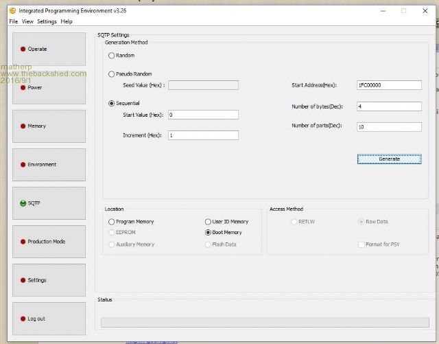

As Chronic says DEVCFG3 has a 16-bit user ID
Go into Advanced mode in the MPLABX IPE and look at SQTP. This can create an automatically incrementing or ID that can be set in DEVCFG3. This can be read/written with the pickit3
The only gotcha is that I haven't quickly been able to find out how/if you can read the location in a program. PEEK doesn't work, nor does a simple CFunction

In the bootflash area (starting at 0x9FC00000) there is plenty of space where you could store a serial number encoded in the hex file then read it using PEEK().
Bootflash is used for a variety of storage including the interrupt jump table, some MMBasic tables and PIC32 config words. The best way to find a suitable location is to write a simple program using PEEK() to dump the memory and pick a place where the flash is 0xFF as that is unused and unprogrammed. Don't use any address above 0x9FC00500 because that might be used by MMBasic in the future.
GeoffEdited by Geoffg 2016-09-02

Posts: 12185
Posted: 05:10am 01 Sep 2016
Geoff's solution should work well
The SQTP settings in the IPE will write to that area so you won't even need to calculate checksums
