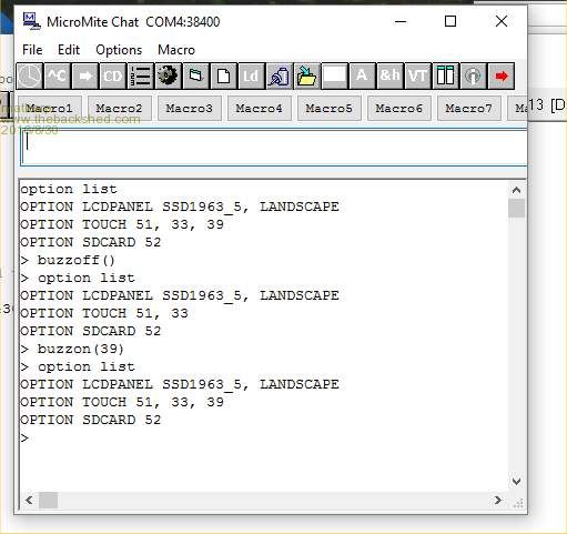

Try these UNTESTED
[code]
Csub buzzoff 'no parameters
00000000
3C029D00 8C420090 03E00008 A0400037
End Csub
Csub buzzon 'call with pin number connected to the buzzer
00000000
3C029D00 8C420090 8C830000 03E00008 A0430037
End Csub

Thats brilliant - well half brilliant.
The buzzoff() works. But buzzon(39) gives a CPU exception 10 error. At address 0x9D0017C4 if thats any help!
WW

Not for me it doesn't

I get buzzed() to 'switch off' pin 39 from OPTION LIST (as in your screen-shot above), but buzzon(39) restarts the MM every time. This occurs both at prompt and in code.
Triple checked everything. CPU is at 100. v5.2 (as per Geoff's website).

Posts: 11906
Posted: 08:49am 30 Aug 2016
Can you post a screenshot of exactly the sequence I did above.
You do have the later version 5.2? Geoff did a very minor update after a couple of weeks.
All the CFunction does is change the value of the OPTION location for the buzzer so the difference can only be that the location is different somehow.

  matherp said   Can you post a screenshot of exactly the sequence I did above.[/quote]
Add the word OPTION in front of each line in my earlier post and that is what I have. I am running a standalone E100 system so no-go for a screen shot!
The 39 is in brackets as I have it 'listed' before the BUZZOFF() sub is called; and it 'disappears' from the list after BUZZOFF() (as per your screen shot).
However, as soon as I run BUZZON(39), I get a reset and the 'CPU exception 10' error message
[quote]You do have the later version 5.2? Geoff did a very minor update after a couple of weeks.[/quote] I am running the version on his website. This could be the issue. Can you link me to the Firmware version you are running there please!
