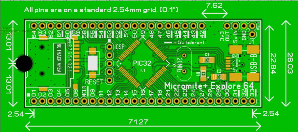

Totally agree with Zonker, and that is the way to do it. Note that one of the GIF's in the constructor pack, is a dimensions one for the E64, so that you can do exactly what you are wanting to do - design a footprint for the E64, that you can use in your own PCB designs, and then just plop in the E64 module as the heart of it later.
As Zonker says, all pins are on a standard 2.54mm/0.1" grid, so it is really easy to lay down some pads according to the dimensions, and save that as your footprint.
You don't need the pads for J1 on your footprint, so then it is just two rows of pads on a standard grid, with three pads to the right of the top row of pads based on the dimensions GIF, which is 7.62mm

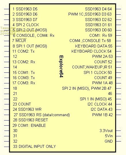

This is my feeble attempt.
2016-08-27_074155_Explore64.zip

I have updated the DEX part to include pin functions.
2016-08-28_030248_Explore64.zip
Phil, I think this is what you are after.

Thanks to all for your help especially TassyJim for his autotrax part, I'm still learning the program and am some way off of making my own parts for it just yet.
