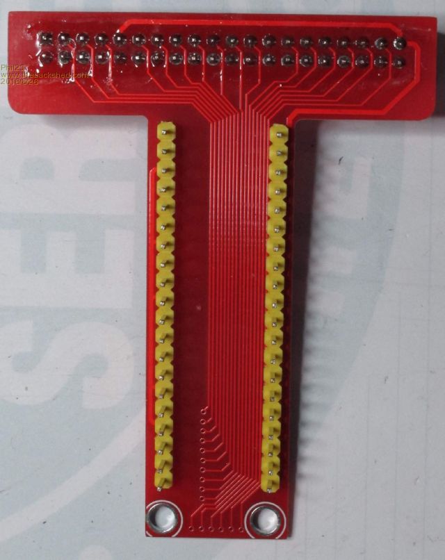

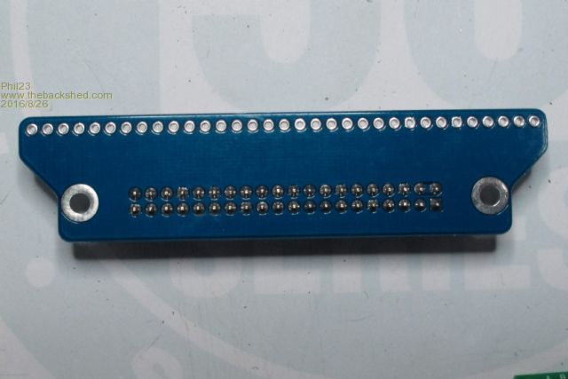

Breakout for Con8 for experimenting on solderless breadboard.

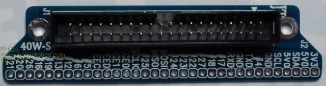

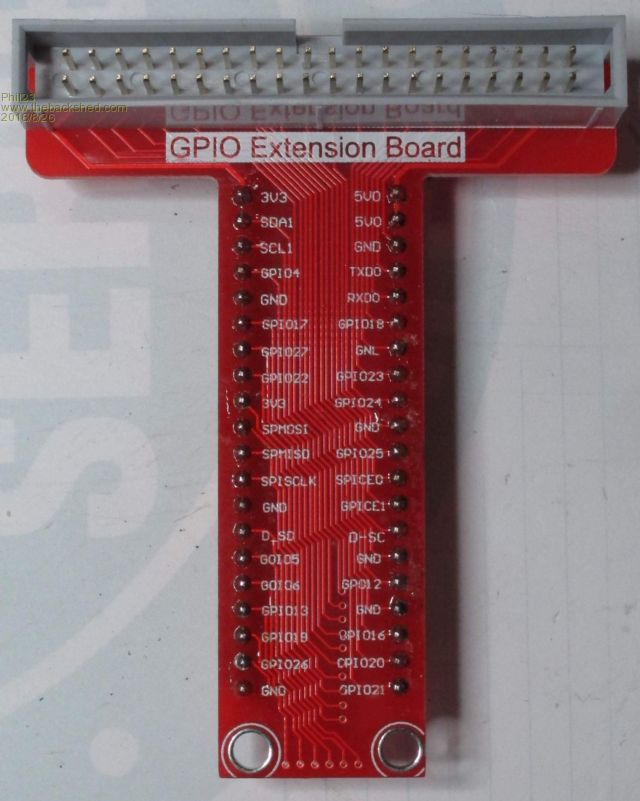

Geoff mentions in SC that there are R-Pi adaptors available to spread the pins.
I've got a few samples & they provided certain limitations as Geoff mentions.
Modifying them could be a bit difficult.

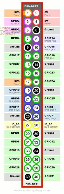

This is the R-Pi 40 pin header:-
On Con8 Pin 1 is Gnd, so Pin 17, GPIO17 is held low.
GPIO02 & GPIO04 are shorted together.
As are all the following:-
GPIO 09
GPIO 25
GPIO 39
GPIO 06
GPIO 14 - Com1 Rx
GPIO 20 - PWM 1C
GPIO 30 - PWM 1B
GPIO 34 - I²C Clock
These are the samples I have.
Phil.

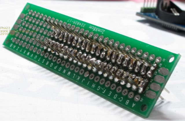

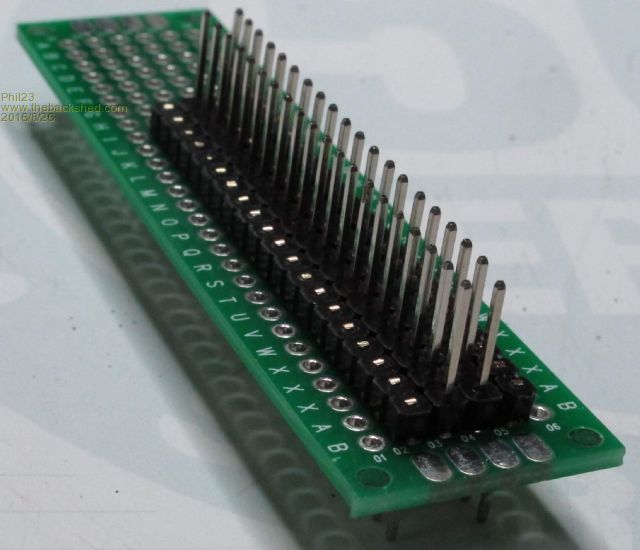

For the time being I've done this:-
Yet to be trimmed down with the Dremel.Edited by Phil23 2016-08-27
