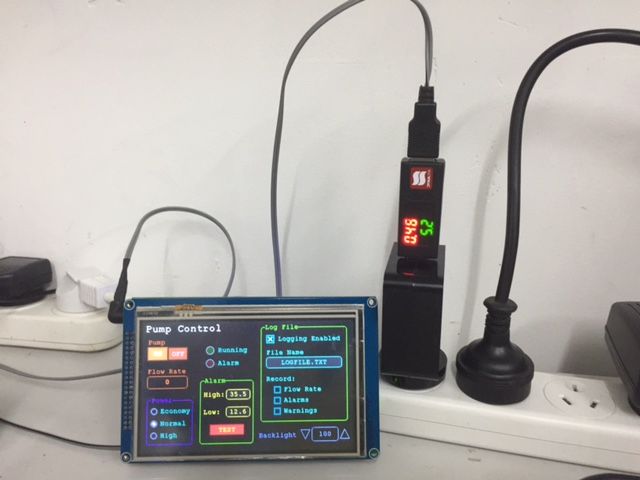

Also noticed Geoff mentions around 500mA with a 5".
Measured what mine was drawing yesterday, with just RTC & screen,
All that was running was the pump demo.
Got 490mA on a USB ammeter.
Didn't try turning brightness down,
got side tracked by the fact that the USB Com12 wouldn't work.
Turned out the PC was shutting down the ports data service at the level of current draw.
Phil.

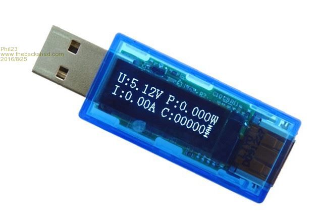

It was just a quick & easy way to measure current with one of these:-
It was handy; no effort required, Lol.
Phil.

Posted: 07:26pm 24 Aug 2016
That's a nice looking one Phill. Beats my LED one.
