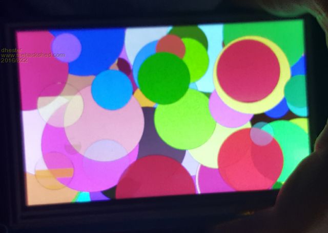

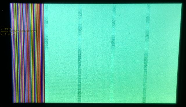

Just got around to constructing my explore100, I got the one with presoldered smd parts.
I powered the board via a wall plug into J1 and bridged the pins to provide power from the usb, and usedbJ6 fro the serial into teraterm on my pc.
I can get the red and yellow leds to blink, got rtc working but I am having problems with the lcd.
I have tried a 5" and 4" ssd1963 I use option lcdpanel, ssd1963_5, L, 48 and get the following results
Also when use a min usb cable from my pc into J1 nothing happens.
Can anyone suggest where to start trouble shooting

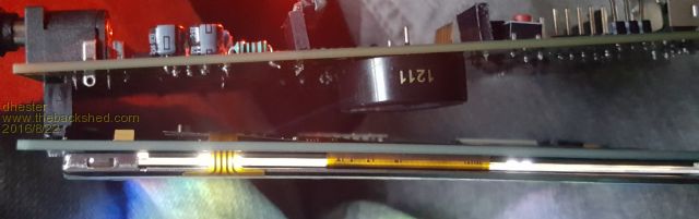

I tried a few things and found if the board is at an angle it works great.
I think it might be a faulty socket, I will get a different one and solder that in to see if that corrects the fault.

It is not very easy to just solder in a new socket. Instead I would recommend running an iron and solder over all the pins of the 40-way connector (CON9) as there may be a 'bad' solder joint. Try this first; and also run an iron on the TFT pins too (many modules from eBay seen here have needed re-soldering!!!!)
Also ensure you use spacers between the TFT PCB and the E100 PCB. At least use a piece of cardboard if you have no spacers.

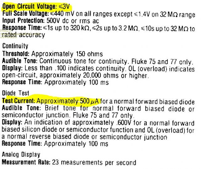

  Grogster said   Provided the board is NOT powered, you should be able to use the 10k or 20k range on your multimeter. Low-ohms range can allow more current to flow in the continuity test then we really want floating around the I/O pins, so don't use those ranges.
So I presume that means I shouldn't use the Continuity/Diode test mode on my old Fluke 77?
I'm probably guilty of poking around things in that mode due to the beeper.

@ dhester - the fact that it works at an angle PROVES there is definitely nothing wrong in terms of possible shorts on the PIC32 chip on the E100 board - phew! What this DOES prove, is that you have issues around the connector to the LCD, and as you have already suggested, perhaps a short or a bad soldering connection there. Normally, it just works, as you know I am sure. Ain't electronics fun!
@ Phil23 - Diode test mode is usually fine too, BUT it depends on the meter. Normally, the diode-test mode on most meters only allows a tiny current to flow, so is ideal, but that is not ALWAYS the case, as it depends on the meter. The manual for that meter will tell you what kind of current-limit the diode-test has. At the end of the day, so long as the E100 board is NOT powered, it should not really care, but PIC's are funny things, and they CAN(and do) actually try to power up via parasitic power from one of the I/O pins, so I always like to use rather strongly current-limited testing methods when poking around MCU I/O pins. This is just ME - by no means perhaps what others would do. Some may even say no special caution is needed, but this is just the way my brain works. Beeper mode on your meter is also fine, PROVIDED it is well current-limited and buffered inside the meter - the manual for the meter will also tell you this. If it doesn't, then assume it doesn't.

  Grogster said  @ Phil23 - Diode test mode is usually fine too, BUT it depends on the meter. Normally, the diode-test mode on most meters only allows a tiny current to flow, so is ideal, but that is not ALWAYS the case, as it depends on the meter. The manual for that meter will tell you what kind of current-limit the diode-test has.
Lol,
Would you believe I can actually find a manual for this meter....
Circa 1986.
Diode Test & Continuity are the same mode. 500ľA.
Thanks.

@ Phil23 - Well done you, finding the manual! I did not know the meter was that old, so well done. With a 500 micro-amp test current, so you'd be fine using the diode test mode.
