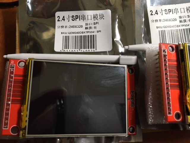

I recently received these two that came with a touch pen included. (ebay alice1101983). One does not work at all but the second has display working but gives the touch error you describe with GUI calibrate. The boards seem to have a additional 3.3v regulator and the touch panel enters the screen near the bottom rather than near the top. Also no TJCTM2402-SPI silk screen.
The web site no longer shows the picture that was there when I bought the items and shows the old image with TJCTM2402-SPI so maybe they send these agauin now. Even the ebay link to 'the items you purchased' has a changed image.

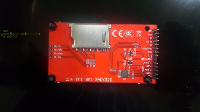

Heres a Pic of the PCB on the bad LCD's
Note the missing pin MISO pin this the fix that got it going.
The wire links are a result of my tests with a different touch panel
@disco4now yes this one also came with a little touch stylus

The two I have are the same as the picture above. I have snipped off the MISO pin and one is working OK now.
