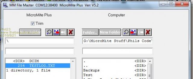

Posted: 02:23pm 20 Aug 2016
Short answer - No.
Long answer:
The maximite XMODEM command allowed copying to and from the SDcard.
The micromite only allows copying to the program memory. The option to do file copying is in the todo list but not yet.
If it happens, the File Manager in MMEdit would make life easy.
If you are only interested in text based files, you can easily incorporate the reading/writing into your own programs.
Alternatively, you could write a Basic XMODEM program to handle the stored files.
This is something I have considered but I am getting too far behind with other programming to make the offer.
