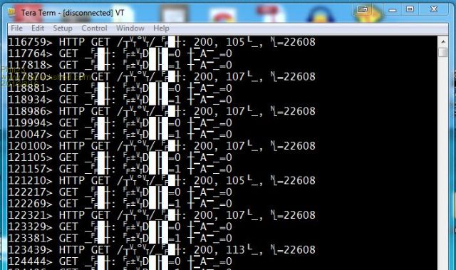

But it won't find Wifi Access points, & it's spitting strange data out the serial port.
This is what I see when I connect to the port at 115200.
Flashed these 2 latest ones with esp-link-v2.2.3
Any thoughts on what it might be.

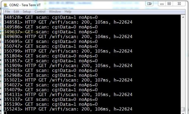

Should also add that it flashes fine with ESPBasic,
And have re-flashed it since the above post;
Can still access it's web page on 192.168.4.1,
But it still won't find my access points.
What it's spitting out the port is a bit different now;
Basically the same, but minus the corruption seen above.
Does it sound like it might be a dud module with faulty flash?
