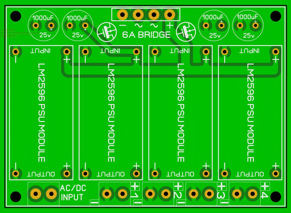

Hi folks.
Here is my latest quick whip-up: A quad-rail PSU. I have often found that I need several voltages at once, and more often then not, one supply has the capability to supply a certain current, while another one does not, so I end up with a collection of PSU modules all connected with wire in a birds-nest mess on my desk. Something had to be done!
This board uses the cheap and readily available LM2596 regulator modules. These are mass-produced, and can be had on eBay for about one buck a piece.
The board is designed to take up to four of these 2596 regulator modules on the one board, providing up to four separately adjustable supply voltages at currents up to 2A on each rail. Each 2596 can be adjusted between 1.25v and 35v depending on input voltage. The input voltage can be AC or DC, and the 6A SIL bridge is along the top-edge of the board to allow easy mounting of a heatsink, if you need higher total currents. There is provision for addition of extra decoupling caps on the DC side of the bridge, but these won't need to be installed if you load is low, and the input voltage is DC to start with. I recommend fitting these 1000uF caps if the input voltage is AC.
The 2596 can actually do up to 3A output, but I tend to de-rate things in order to increase the lifespan of the device - heat is an electronic killer. Due to it's high efficiency, you can get up to 2A out of each rail without any heatsinking, as the module uses the bottom copper as a basic heatsink. Generally speaking, anything more then 1.5A continuous on any of these rails, and I would add a heatsink. For sporadic loads up to 3A, you can get away with no additional heatsinking at all. Heatsinks could be simple stick on ones, or a more elaborate bar-type-thing that spans all four modules at once, pressing onto each of the 2596 IC packages, as they are all in-line.
I have ordered some of these boards, but if anyone is interested, let me know and I could put up a ZIP file here with the gerbers and drill data so anyone can make their own. Using the likes of Shenzhen-2U, you can get ten of these boards for US12.....Edited by Grogster 2016-08-15

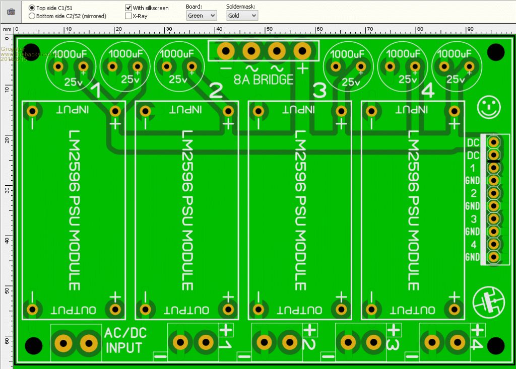

Posts: 10109
Posted: 02:51am 15 Aug 2016

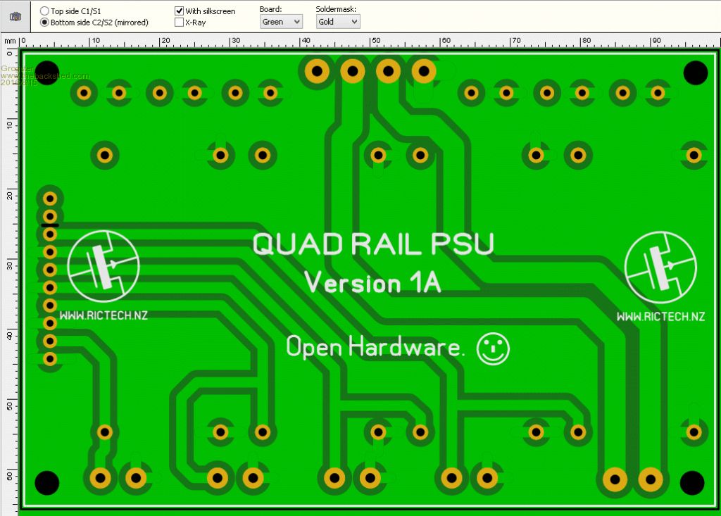

OK, I have decided to stick with the board as-is, pretty much, but extending it out to 100mm horizontally. It was 91mm before, so it is only 9mm wider then before.
This version adds a couple more 1000uF caps for good luck. You only need to install all six if you are expecting to be running a couple of amps from each rail, although, installing them all won't hurt. For light loads, you would only need to install two or four. But I like to use as many reservoir caps as I can(within reason) for high loads.
I've also added a ten-way header on the right side, for those of us like me who like to have multi-pin plugs for several different supply voltages to cut down on space and make connection faster over having lots of terminal blocks. This header will also allow easy adding of an LED display board later for those that want it.
Somewhat annoyingly, all those LED meters seem to have the current sense path in the return(negative lead) side of the load not the supply(Positive lead) as most of us would tend to wire up an ammeter. This just means you have to separate out the ground return wires and cannot use a common ground between all the rails if you want to use the displays. IE: Each rail's ground return must be electrically separate from the other rail's ground return paths. An irritation, but probably not a deal-breaker.
Gerber files(RS-274X) and Excellon drill data ZIP file... Edited by Grogster 2016-08-16

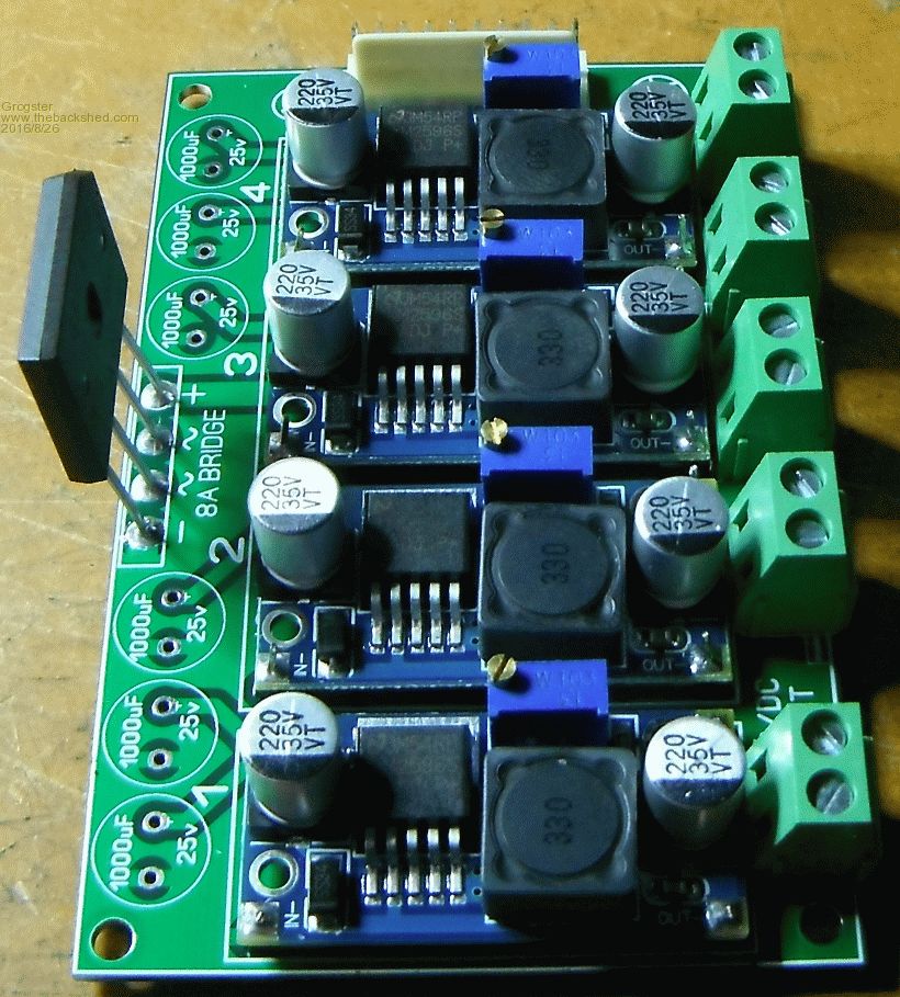

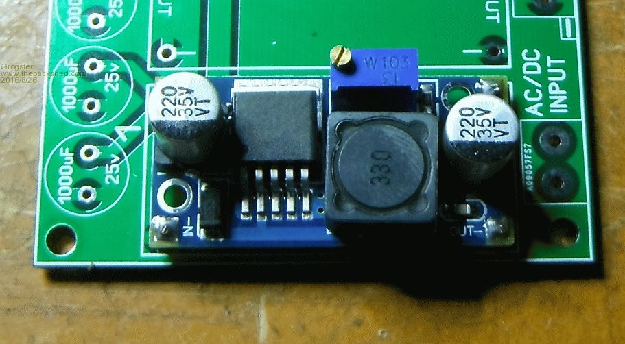

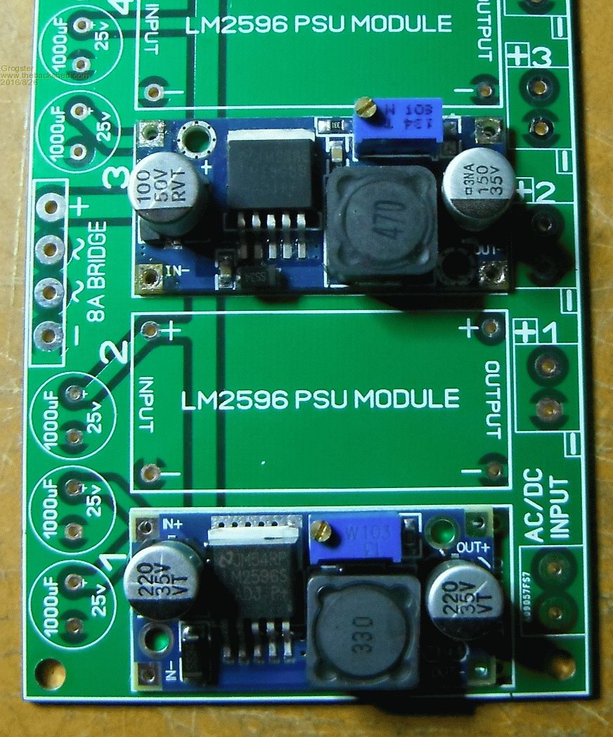

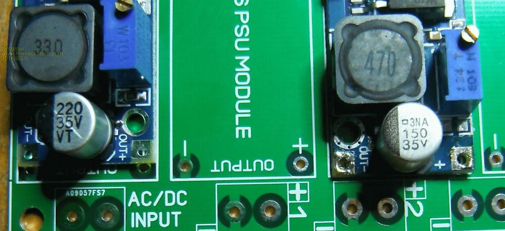

The damn new modules use a slightly different layout, and the new boards are about 2mm SHORTER then the original ones I designed the board for - curses!
I can still use the new modules on the PCB, I just have to mount one end in the way I was planning, and run some short(but thick) wire links up to the other end. It looks messy though, and I like a neat layout.

  Grogster said   The damn new modules use a slightly different layout, and the new boards are about 2mm SHORTER then the original ones I designed the board for - curses!
Can you not just use header pins (removed from plastic housing) slightly angled inwards to keep it neat for now?

I still don't consider header pins on an angle to be neat.
I have done it with heavy wire bent into a neat shape. I will put up a photo later.
Posts: 10109
Posted: 12:01am 26 Aug 2016

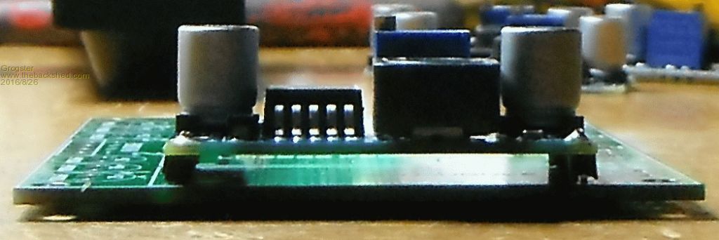

Well, I will have to eat a little humble pie - WW was right, his method works fine, and it is perfectly stable, and the pin-headers only need to be angled just a little off the vertical - you would not know unless you looked really closely.
This looks fine, so it is not the end of the world afterall.

Looks good - but would have been even neater if you had removed the header's plastic
However it does become more fiddly to construct . . .
Posts: 10109
Posted: 01:58am 26 Aug 2016
The header plastic provides a nice even spacing off the main-board, but you were right - it looks fine.

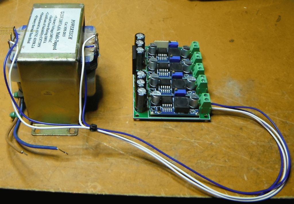

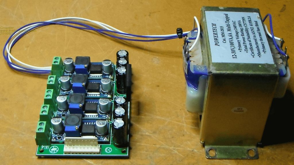

EDIT: Photo of the unit 99% complete. No reservoir caps in place yet, as I don't have 25v ones. I will get some from Jaycar maybe even at the weekend.

I had a call-out in town today, so I called past Jaycar and grabbed some 1000uF 25v caps for the DC reservoir. I also dug up an old 6A tranny from the parts bin just for the purposes of setup and testing. I'll probably end up using this tranny as I have it spare, and it is doing nothing but gathering dust in the shed anyway.
You might not even need the reservoir caps depending on how you use the module and what you are feeding it from, but I like to have them though, as it gives the PSU some headway and stability for different types of loads etc. Tomorrow, I will hook up some dummy loads to the outputs and run some more tests. I need to fix the rectifier bridge to a heatsink before I pull more then an amp or so through it, but that is also on tomorrow's agenda.
I would have preferred low-ESR reservoir caps, but they were slightly larger in physical size for the same voltage and capacitance and would not physically fit on the board side-by-side, so I had to stick with bog-standard electro's. Still, this is 6000uF of reservoir, so for all but the thirstiest of loads......
