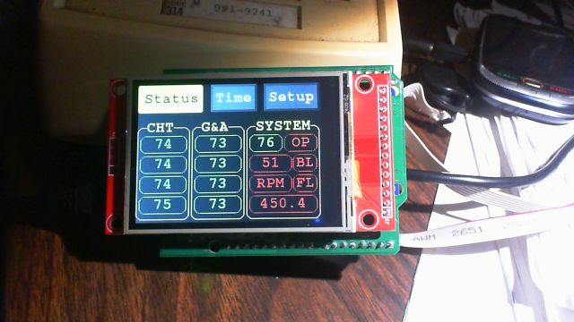

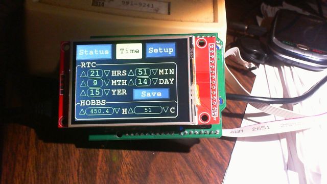

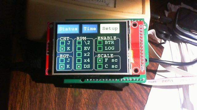

Yep..! It works like a champ...
I did this on a small "tabbed" screen setup
I does seem to get crowded kinda fast, but doable...
When things get to small, the "fat finger" starts getting into trouble...
Must be time for a bigger panel..!!

Humm... I did look up the code... From 8/22/15... It's not "up to date" with latest GUI firmware, but could work as a starting point fot the "tab" objects...
' LTC2983 Test Program for MM+470 on the GC microboard 2
Option explicit
' Assign Object Values
Const status_button=1
Const data_button=2
Const setup_button=3
Const cht1_led=4
Const cht2_led=5
Const cht3_led=6
Const cht4_led=7
Const egt1_led=8
Const egt2_led=9
Const egt3_led=10
Const egt4_led=11
Const temps_stat_frame=12
Const cht_stat_box=13
Const egt_stat_box=14
Const cht_data_frame=15
Const cht1_data_box=16
Const cht2_data_box=17
Const cht3_data_box=18
Const cht4_data_box=19
Const egt_data_frame=20
Const egt1_data_box=21
Const egt2_data_box=22
Const egt3_data_box=23
Const egt4_data_box=24
Const cht_thermo_type_frame=25
Const cht_jtype_button=26
Const cht_ktype_button=27
Const egt_thermo_type_frame=28
Const egt_jtype_button=29
Const egt_ktype_button=30
Const rpm_count_frame=31
Const rpm_dev2_button=32
Const rpm_even_button=33
Const rpm_mul2_button=34
Const rpm_mul4_button=35
Const rpm_dis_button=36
Const function_enable_frame=37
Const bt_radio_checkbox=38
Const rs485_checkbox=39
Const next_button=40
Const done_button=41
Dim screen_state=status_button ' current screen #, set to 1
Dim old_screen_state,touch_state,old_touch_state ' last screen #, returned object # touched
Font #5,1 ' mid sized bold
CLS
' Create "TAB" buttons
GUI button next_button,"Next",0,0,MM.FontWidth*7,MM.FontHeight*2,RGB(yellow),RGB(gray)
GUI button done_button,"Done",127,0,MM.FontWidth*5,MM.FontHeight*2,RGB(yellow),RGB(gray)
GUI hide next_button, done_button
GUI button status_button,"Status",0,0,MM.FontWidth*7,MM.FontHeight*2,RGB(yellow),RGB(gray)
GUI button data_button,"Data",127,0,MM.FontWidth*5,MM.FontHeight*2,RGB(yellow),RGB(gray)
GUI button setup_button,"Setup",220,0,MM.FontWidth*6,MM.FontHeight*2,RGB(yellow),RGB(gray)
' Create "Status Screen"
GUI frame temps_stat_frame,"Temps",0,75,320,125,RGB(yellow)
GUI displaybox cht_stat_box,7,100,MM.FontWidth*19,MM.FontHeight+5,RGB(red),RGB(black)
CtrlVal(cht_stat_box)="CHT 1 2 3 4"
GUI led cht1_led,139,104,20,RGB(green)
GUI led cht2_led,188,104,20,RGB(red)
GUI led cht3_led,237,104,20,RGB(yellow)
GUI led cht4_led,285,104,20,RGB(yellow)
GUI displaybox egt_stat_box,7,150,MM.FontWidth*19,MM.FontHeight+5,RGB(red),RGB(black)
CtrlVal(egt_stat_box)="EGT 1 2 3 4"
GUI led egt1_led,139,154,20,RGB(green)
GUI led egt2_led,188,154,20,RGB(green)
GUI led egt3_led,237,154,20,RGB(green)
GUI led egt4_led,285,154,20,RGB(green)
GUI hide temps_stat_frame,cht_stat_box,egt_stat_box
GUI hide cht1_led,cht2_led,cht3_led,cht4_led
GUI hide egt1_led,egt2_led,egt3_led,egt4_led
' Create "Data" Screen
GUI frame cht_data_frame," CHT ",0,75,110,159,RGB(yellow)
GUI displaybox cht1_data_box,15,90,MM.FontWidth*5,MM.FontHeight+5,RGB(red),RGB(black)
CtrlVal(cht1_data_box)="xxx"
GUI displaybox cht2_data_box,15,125,MM.FontWidth*5,MM.FontHeight+5,RGB(red),RGB(black)
CtrlVal(cht2_data_box)="xxx"
GUI displaybox cht3_data_box,15,160,MM.FontWidth*5,MM.FontHeight+5,RGB(red),RGB(black)
CtrlVal(cht3_data_box)="xxx"
GUI displaybox cht4_data_box,15,195,MM.FontWidth*5,MM.FontHeight+5,RGB(red),RGB(black)
CtrlVal(cht4_data_box)="xxx"
GUI frame egt_data_frame," EGT ",115,75,110,159,RGB(yellow)
GUI displaybox egt1_data_box,130,90,MM.FontWidth*5,MM.FontHeight+5,RGB(red),RGB(black)
CtrlVal(egt1_data_box)="xxxx"
GUI displaybox egt2_data_box,130,125,MM.FontWidth*5,MM.FontHeight+5,RGB(red),RGB(black)
CtrlVal(egt2_data_box)="xxxx"
GUI displaybox egt3_data_box,130,160,MM.FontWidth*5,MM.FontHeight+5,RGB(red),RGB(black)
CtrlVal(egt3_data_box)="xxxx"
GUI displaybox egt4_data_box,130,195,MM.FontWidth*5,MM.FontHeight+5,RGB(red),RGB(black)
CtrlVal(egt4_data_box)="xxxx"
GUI hide cht_data_frame,egt_data_frame
GUI hide cht1_data_box,cht2_data_box,cht3_data_box,cht4_data_box
GUI hide egt1_data_box,egt2_data_box,egt3_data_box,egt4_data_box
' Create "Settup" Screen
GUI frame cht_thermo_type_frame,"CHT",0,75,80,70,RGB(yellow)
GUI radio cht_jtype_button,"J",15,85,25,RGB(green)
GUI radio cht_ktype_button,"K",15,115,25,RGB(green)
CtrlVal(cht_jtype_button)=1
GUI frame egt_thermo_type_frame,"EGT",0,165,80,70,RGB(yellow)
GUI radio egt_jtype_button,"J",15,175,25,RGB(green)
GUI radio egt_ktype_button,"K",15,205,25,RGB(green)
CtrlVal(egt_jtype_button)=1
GUI frame rpm_count_frame,"RPM",185,75,115,160,RGB(yellow)
GUI radio rpm_dev2_button,"\2",200,105,25,RGB(green)
GUI radio rpm_even_button,"EV",200,135,25,RGB(green)
GUI radio rpm_mul2_button,"x2",200,165,25,RGB(green)
GUI radio rpm_mul4_button,"x4",200,175,25,RGB(green)
GUI radio rpm_dis_button,"DS",200,205,25,RGB(green)
CtrlVal(rpm_dis_button)=1
GUI hide cht_jtype_button,cht_ktype_button
GUI hide cht_thermo_type_frame
GUI hide egt_jtype_button,egt_ktype_button
GUI hide egt_thermo_type_frame
GUI hide rpm_dev2_button,rpm_even_button
GUI hide rpm_mul2_button,rpm_mul4_button,rpm_dis_button
GUI hide rpm_count_frame
'End
' set some values...
CtrlVal(cht1_led)=1
CtrlVal(cht2_led)=1
CtrlVal(cht3_led)=1
CtrlVal(cht4_led)=1
CtrlVal(egt2_led)=1
GUI interrupt TouchDown,TouchUp
'SetTick 1000,blink
' ----------- Main
If screen_state<>old_screen_state Then redraw
If touch_state<>old_touch_state Then
Print "Touch "; touch_state; " Screen "; screen_state
Print "EGT Setup ";
If CtrlVal(egt_jtype_button) Then Print "J ";
If CtrlVal(egt_ktype_button) Then Print "K ";
Print " CHT Setup ";
If CtrlVal(cht_jtype_button) Then Print "J ";
If CtrlVal(cht_ktype_button) Then Print "K ";
old_touch_state=touch_state
Print ""
EndIf
Loop
' -------- Sub's
Sub blink
If CtrlVal(cht1_led) Then
CtrlVal(cht1_led)=0
CtrlVal(egt1_led)=1
Else
CtrlVal(cht1_led)=1
CtrlVal(egt1_led)=0
EndIf
End Sub
Sub TouchDown
'touch_state=Touch(ref)
'If touch_state>=1 And touch_state<=3 Then screen_state=touch_state
'Print touch_state screen_state
'If screen_state<>old_screen_state Then redraw
End Sub
Sub TouchUp
touch_state=Touch(lastref)
End Sub
Sub redraw
Select Case screen_state ' find out which control was touched
Case status_button ' restore status screen
GUI hide status_button
RBox 0,0,MM.FontWidth*7,MM.FontHeight*2,3,RGB(yellow),RGB(yellow)
Text 10,12,"Status",L,5,1,RGB(black),RGB(yellow)
If old_screen_state=data_button Then ' hide data screen objects
GUI restore data_button
EndIf
If old_screen_state=setup_button Then ' hide setup screen objects
GUI restore setup_button
GUI hide rpm_mul2_button ',rpm_mul4_button ',rpm_dis_button
EndIf
GUI restore temps_stat_frame,cht_stat_box,egt_stat_box
GUI restore cht1_led,cht2_led,cht3_led,cht4_led
GUI restore egt1_led,egt2_led,egt3_led,egt4_led
Case data_button ' restore data screen
GUI hide data_button
RBox 127,0,MM.FontWidth*5,MM.FontHeight*2,3,RGB(yellow),RGB(yellow)
Text 137,12,"Data",L,5,1,RGB(black),RGB(yellow)
If old_screen_state=status_button Then ' hide status screen objects
GUI restore status_button
GUI hide cht_stat_box,egt_stat_box
EndIf
EndIf
GUI restore cht_data_frame
GUI restore cht1_data_box,cht2_data_box,cht3_data_box,cht4_data_box
GUI restore egt_data_frame
GUI restore egt1_data_box,egt2_data_box,egt3_data_box,egt4_data_box
Case setup_button ' restore setup screen
GUI hide setup_button
RBox 220,0,MM.FontWidth*6,MM.FontHeight*2,3,RGB(yellow),RGB(yellow)
Text 230,12,"Setup",L,5,1,RGB(black),RGB(yellow)

Use the basic tabbed framework and "touch action" sections, Insert your objects for the main sections of the screen and see how your screens work...
Post them back here so we can take a look..!

Just gave it a try on my CG board the same as yours.
Crashed at line 77;
[Code][77] GUI displaybox cht_stat_box,7,100,MM.FontWidth*19,MM.FontHeight+5,RGB(red),RGB(black)
Error: 456 is invalid (valid is 16 to 320)
[/code]
Presume that means I need to add the font you used in line 60.
Mid Sized Bold.
Phil.

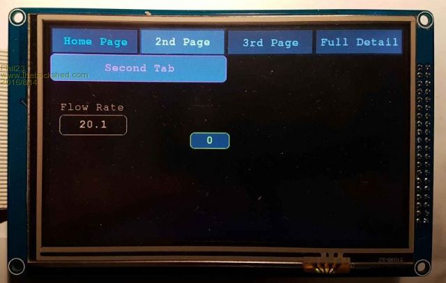

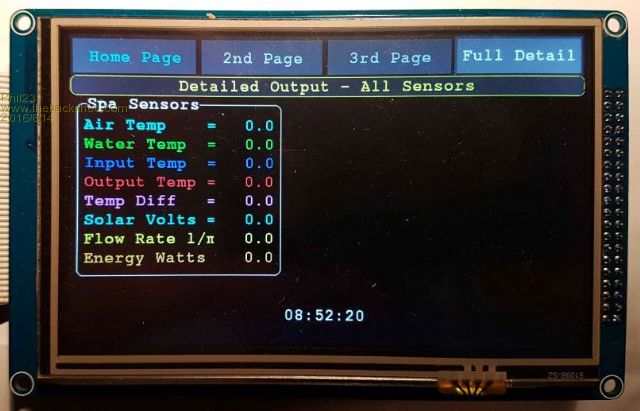

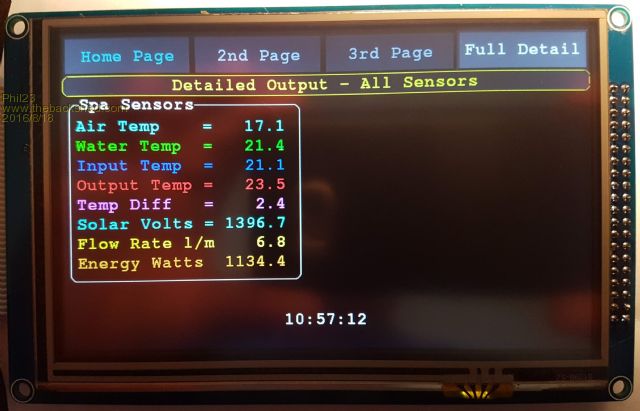

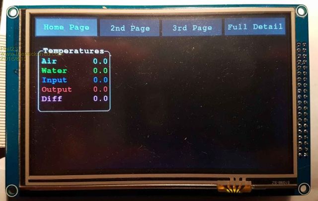

Seems to be working well;
Have trapped the screen update issues caused if the interrupt occurs during the Basic Graphics updates.
Page 4 has a mix of Basic & Advanced Graphics & it will be intended to display all Sensor data & key variables used in the control process.
Mostly for Debugging & seeing what things are doing.
That will amount to about 40 variables to display, which I might split over 2 pages;
Way to many for them all to be advanced objects.
Data is being collected from 3 other MM's via HC-12's.
This one will poll for that data & acknowledge it's receipt.
Have that Com stuff running on a 28P Backpack ATM;
Multiple Basic Graphics Pages with switching.
Tried building a data string and using it with GUI CAPTION on Page1,
but the Caption string doesn't update.
Edit;-
Posted the image of the 4 tab twice, Fixed now.
1st Tab;
Data not working & needs changing
2nd Tab;
Just mucking about on it.
4th Tab;
It's the mix of Basic & Advanced & all working fine now.
Edited by Phil23 2016-08-16

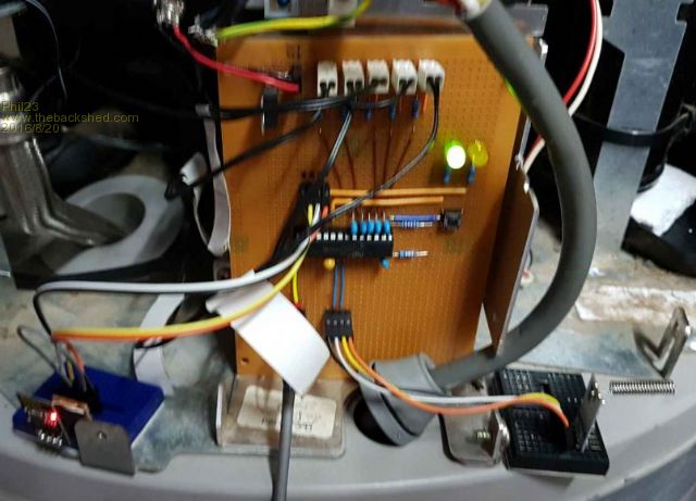

Already have the Coms code for retrieving the data from the other MM's running on a 28 pin backpack.
Just need to bring the relevant Subs over.
15 Sensors & about 5 derived outputs.
Cheers.

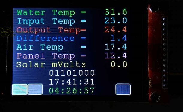

  Zonker said  I would love to see the sensor data on those value readouts...

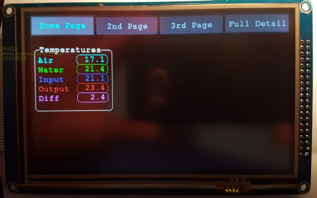

Got some there now.
This data is being received on Com1 by a HC-12, which Polls the two other MM's,
one on the Spa, the other in the Heat Pump.
Home page is only Advanced Graphics.
Still requires 10 Objects to display 5 items of data.
Wouldn't mind seeing the option to suppress the border in the DISPLAYBOX though.
The other thing that would be good is display precision in the NUMBERBOX,
so you don't get situations where the decimal is dropped.
IE
29.8
29.9
30
30.1
30.2

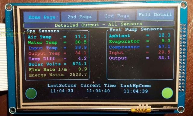

Just updated Tab 4 a bit.
Now displaying thermistor data from the heat pump.
Thermistors might need a bit better calibration yet.
Energy output is calculated from flow rate on the basis of 4.2kJ to raise 1 litre if water 1°C (Yes, I know, it's a kilo really...).
1kJ=0.000278kWh; then kWh's back to Watts.
Not bad, the 2600 Watts out for the 730 Watts of electricity in.
Incidentally, that tab would require 37 advanced GUI objects if it was all advanced graphics.
Currently it's using 5 & I can't break it yet.
Cheers.

[Quote=Zonker]Where do you get the sensor data from..?
[/quote]
The Spa has 4 DS18B20's installed in it & a flow sensor.
There's a small garden solar panel on the roof with the panels & a DS18B20 attached.
The Spa has it's own LCD Backpack to monitor all those & control the pumps & valves.
It has an ESP8266 on the console & a HC-12 on Com1.
The heat pump just has a bare 28 pin on protoboard that monitors the existing 5 thermistors in the unit.
It has the same wireless modules as the other one.
The 5" screen is connected to an E64 & it polls both the other.
Did you get my PM?
If you drop me an email address it can reply to that.
Phil.
Phil23
Joined: 27/03/2016
Posts: 1667
Posted: 09:59pm 19 Aug 2016
Just Adding to the above.
This is the 28 pin backpack that currently runs the Spa.
Uses a 3 level version of the Parking Sensors Menus to set the variables.
It will be replaced by a CGMicroboard2, with 2.8" LCD to obtain enable a better interface with Advanced graphics, but also because it's clean out of pins.
The one in the heat pump is still evolving.
It has the thermistors connected at the top, two LED's;
One indicated the code is still running, the second shows that Coms are happening.
It's the one that reads the flow meter at the moment, as I currently don't have a spare pin left on the Spa one to connect it to.
A 64 pin CG board will fix that, & the flow meter will be monitored by the Spa controller.
Phil
